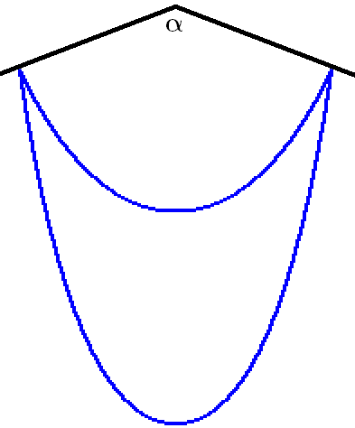

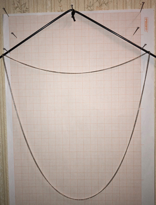

and on one... corner.

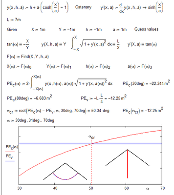

Can you determine (numerical or symbolical - better with Mathcad and without friction) the critical value of the alpha angle when the chain falls off the corner?

You can determinate this angle so too
One try of solution in attach! But I am not sure - is it correct!

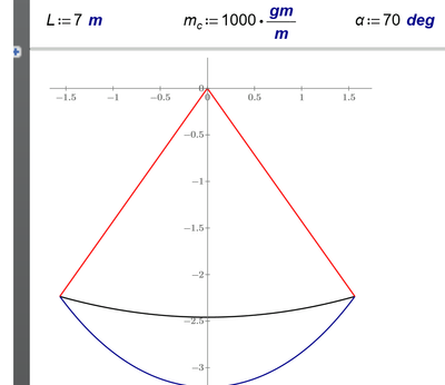

I feel it is a solution - a numerical solution. Check please Mathcad 15 sheet in attach.
anim2.gifI am waiting for one symbolical solution. What is it 108-109 deg?
This angle is equal 2*50.34 deg. I hope in is equal n/m Pi. n and m -?
