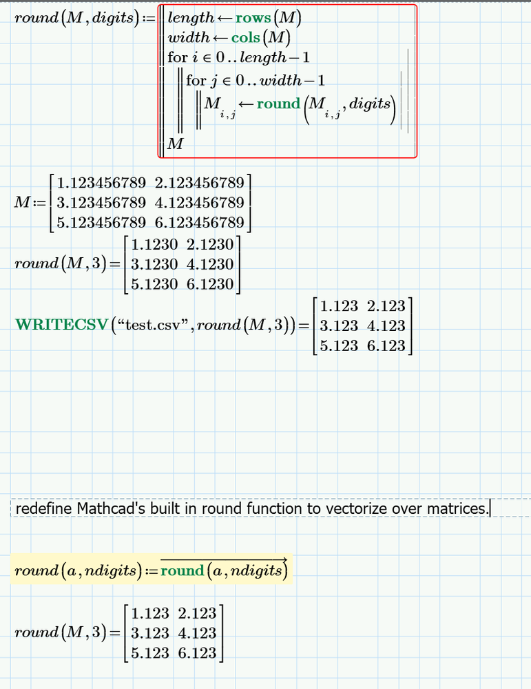

I'm using WRITECSV to write the contents of a matrix to a .CSV file. The WRITECSV function writes the contents with full precision, giving me numbers with 18 decimal places. I want to round the elements to a few decimal places. I wrote a function to do this, but it feels kind of clunky. Is there a native way to accomplish what I'm trying to do? I'm using Prime 11.
16 REPLIES 16
Oops, I realized that I redefined the native function "round". Not good. But my basic question remains.

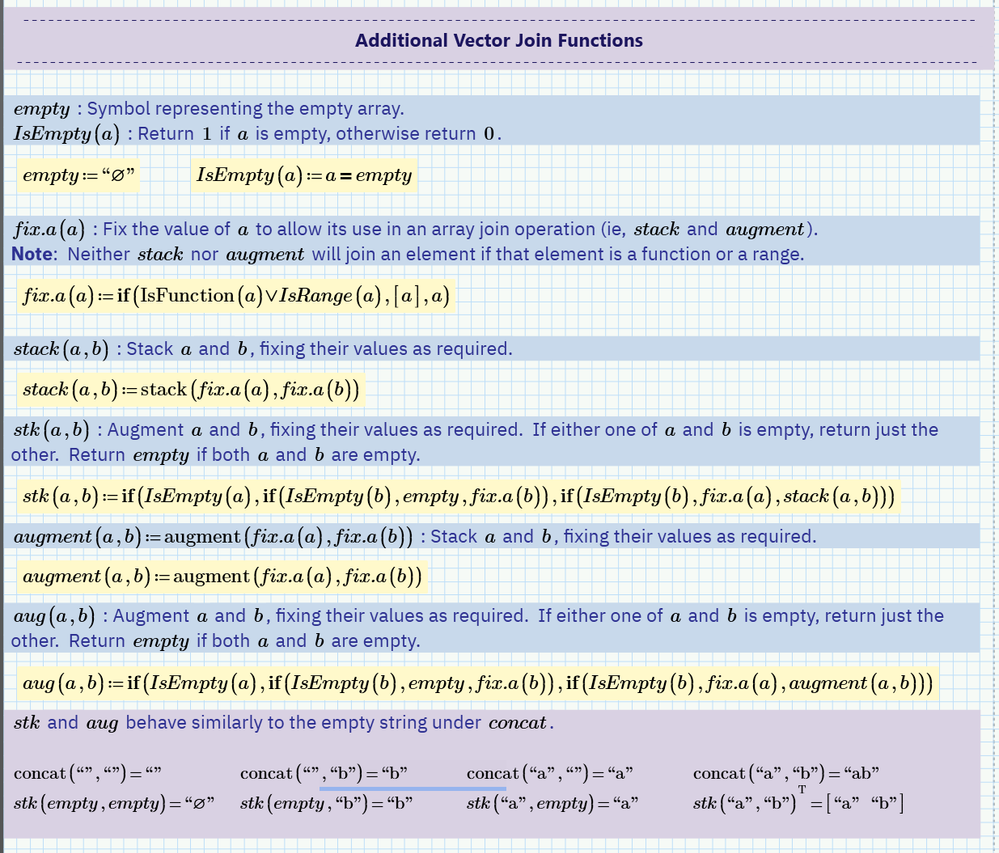

Funnily enough, I didn't realise (or, rather, had forgotten) that round doesn't work over matrices until a couple of weeks ago.  It was rather frustrating hunting down the error in my program because I (naturally, IMO) expected the rounding functions to vectorise over matrices.  It didn't occur to me that they only operated over scalars and vectors of scalars!  So, I added suitably modified versions of round, ceil, floor, etc, to my library of functions ... only to discover shortly afterwards that I already had versions in some older worksheets!
There are a few other functions that don't behave intuitively for me.  For example, stack and augment don't work with ranges or functions.  I also miss the empty-array feature found in many other programming languages, so I've emulated it as well.
This next one probably doesn't interest many people, but I was again taken by surprise when I realised that the random number functions can't generate random complex variates, nor do they have a matrix-generation option, just a vector one.  Still, soon fixed.
The functions shown all run in Mathcad Express and Mathcad Prime.  (You might notice that I use a modified round function in imunif)
Stuart

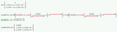

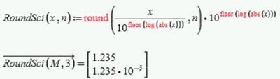

Unfortunately, the element-wise rounding didn't accomplish my end goal. I wanted it to round the mantissa when working with numbers in scientific notation. Do you see an elegant way to accomplish that?
Here was Chatgpt's solution to my question
I couldn't figure out how to incorporate the vectorization (element-wise) operator into the function definition.

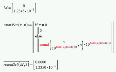

And after discovering a divide-by-zero limitation, I landed on this:

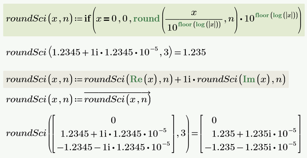

If you want to modify your function to vectorize over arrays, I'd use turn your function into a local function (roundsci, say) within roundSci, then vectorize over the call to it inside roundSci.  Unfortunately, I can't even create a program inside Mathcad Express so I can't show what I mean.

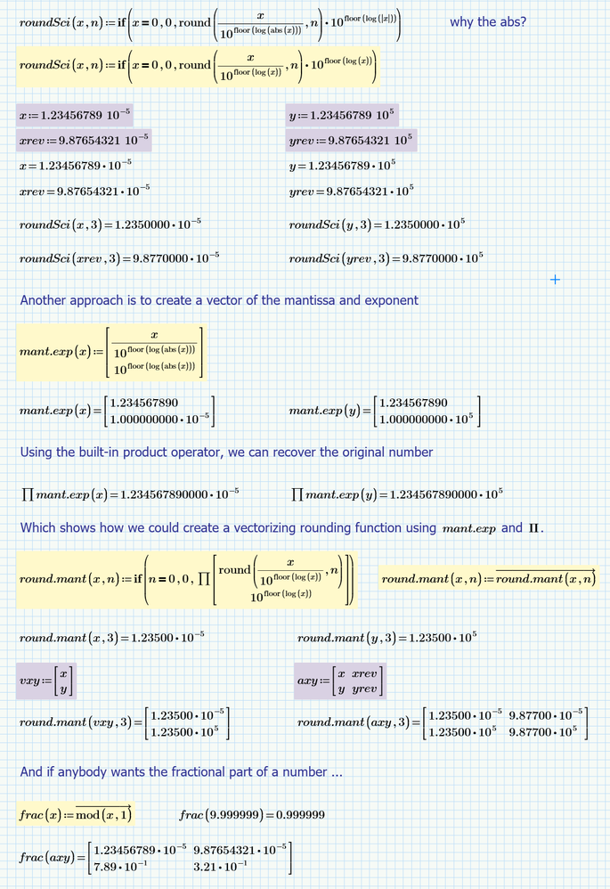

However, here's another possibility that explicitly splits a number into the mantissa and exponent, rounds the mantissa and then combines them again.

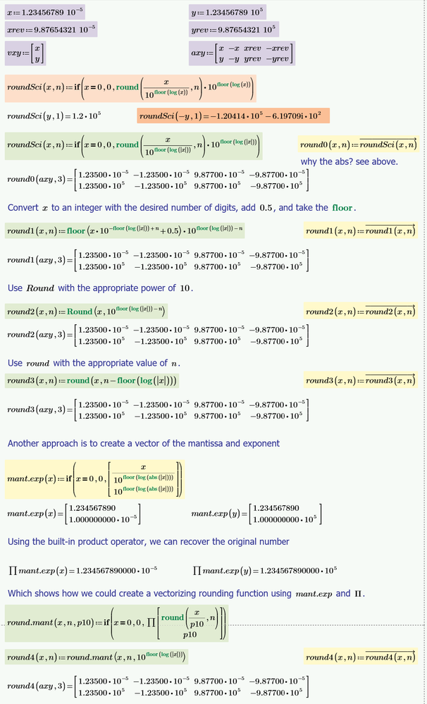

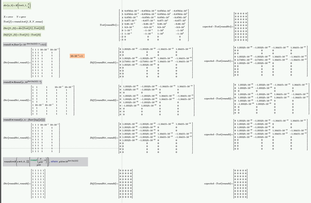

"Here be roundoff errors 2025 10 31 D.png":
More numerical shenanigans.
Stuart

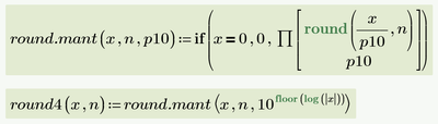

(To:StuartBruff)
Asking if x=0 is better done in round4, otherwise ....  👿
According fractional part of a number.
The fractional part of x=9.99 clearly is 0.99 -> floor(x) + 0.99 = x
But what should be considered the fractional part of x=-9.99 ??
Should it be
+0.99 as sign(x)*(floor(|x|)+0.99) = x
or
-0.99 as sign(x)*floor(|x|) -0.99 = x
or
+0.01 as floor(x)+0.01 = x
According to aunt Wiki (Fractional part)  its -0.99 (as your function correctly returns) while +0.01 would be denoted by curly braces.
Also uncle Wolfram (Fractional Part) uses -0.99 and so I guess we can say that your implementation follows the main stream.
Looks like nobody likes my first intuition which would have been frac(-0.99)=+0.99 (just looking at the numbers after the decimal point and including the latter) 😞
StuartBruff
(To:Werner_E)
Yes, it would have been better to include the x=0 part in round4.  TBH, I thought I had done, as well as adding the x=0 to some of the other round{n} functions.
I've corrected them in the attached Mathcad Express 10 worksheet ... I hope.
I chose trunc for frac on the basis that trunc(z) + frac(z) = z.
Oh, and I've moved frac to another worksheet entirely as part of a Mathcad Enhancement Proposal to extend the truncation and rounding functions (and mod) to matrices and with all complex arguments.
Stuart

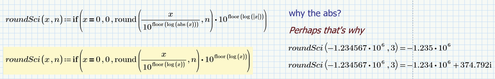

Thanks, I really appreciate the time that you folks put into this! I ran into another problem. The rounding function didn't properly round complex numbers in scientific notation if the real and imaginary parts had different exponents. This is what I landed on. I went with the more verbose form so I wouldn't have to remember later what the native product function was 😉
(To:MJ_10071773)
It looks to me that your picture shows that the numbers are correctly rounded to 3 significant digits, aren't they?
EDIT: Ah, I see. You were referring to Stuarts original roundSci function.
You may fix it a little bit shorter that way:
