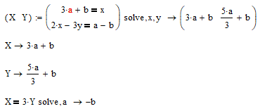

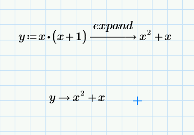

You should never resort to copy and paste but rather assign the results of a symbolic evaluation to a function or a variable and use that for further calculations.
Here are two simple examples
Note that the results in the first example (which where assigned to variables) can only be used in symbolic evaluations (because a and b were unknown), while in the second example the function created can be used numerically as well.
