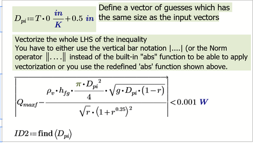

Tested a solution block in Part 1 of attached with scalar variables. Works just fine.
However, when I change to column vector variables in part 2, I think that my element-wise array multiplication and division is not working out.
Suggestions for correcting part 2 will be appreciated.
Using Mathacd Prime 10.0.1.0.

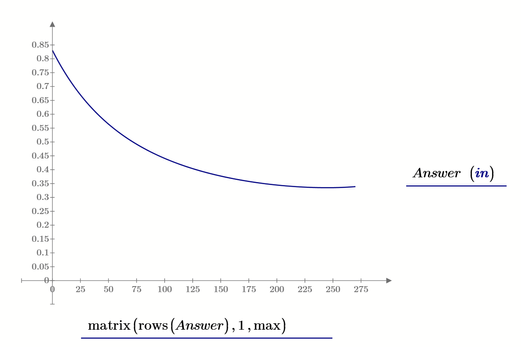

I am not sure if plotting the vector of ID values over their indices makes sense to you, but because we defined no range variable "i" we can't do this now the way Terry did.
However, if you still want to generate this exact plot, you can just use a vector with the index values on the x-axis:
Now for an explanation why your attempt failed and how it could be fixed.
The expression you used (the one with the two vectorized products, simplifies to a simple scalar. both expressions you vectorize create a vector, as intended. But then these two vectors are multiplied and Prime of course use scalar vector multiplication to do so.
You would have to vectorize the whole left  hand size of your inequality. This creates a vector, but we have two problems now:
1) the "abs" function is one of the built-in functions which cannot be vectorized. There are three workarounds possible: Using the vertical bar notation instead of the "abs" function, using the Norm operator or redefining the "abs" function with itself.
I'd prefer the vertical bar notation, but the other approaches are also shown in the attached sheet.
2) Because you use just a single scalar guess value Prime is not able to find a (single) value which would be solution for all 271 input triples.
Solution to this is using a guess vector for D.pi the same size as the input vectors. An easy method to create such a guess is to multiply one of the input vectors by zero, divide by its unit and apply a length unit and then add the desired guess value of 1in (the solve block would also work with 0 in as guesses).
So to summarize: What you have to do to make your approach work ist
1) define a guess vector instead of just a single scalar
2) use the vertical bar notation and vectorize the whole LHS of the inequation.
But let me repeat that this is not the approach I would prefer. I was just explaining what failed and how to get around it for your information as knowing about it might be useful in other situations.
Prime 10 sheet attached
