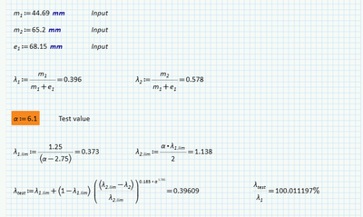

I am trying to create a solve block to calculate the value of alpha as per the below equations:
I have never used solved blocks before so hitting a bit of a stumbling point. I have found through manual iteration my required value of alpha as below:

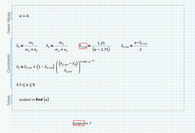

I am trying to put this together into a solve block, but not sure where I am going wrong:
I've attached the sheet pictured above also.
Any help much appreciated, thank you. This will probably be a very simple solve and it is just my lack of understanding of the program hindering me!

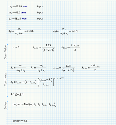

You have five equations and you need to solve for 5 variables to solve the five equations.

That's great thanks, I managed to get it set up as per below:
Greatly appreciate the help!
