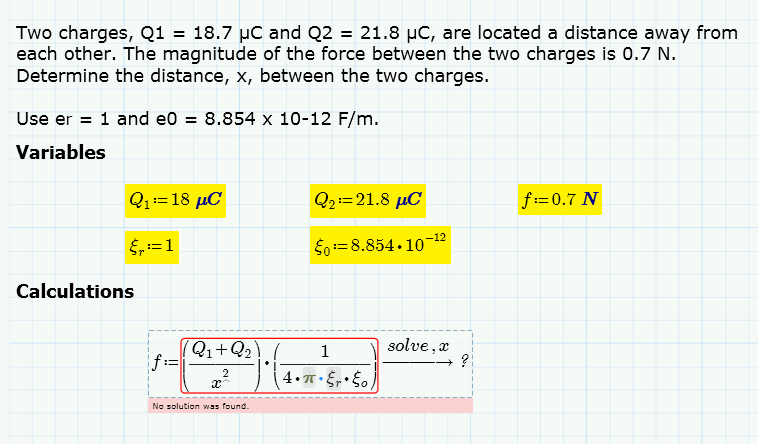

Hi
I am trying to solve for x but I get no solution found.
thanks
You need to use the boolean (comparison) equals sign. You used the definition equals sign.

http://patrick.kohl.pagesperso-orange.fr/spectro_part/spectro_part_1.htm
Attention entre e0 et eo dans la formule

Aaron,
It is necessary to destroy voting equation (f: = Q1 * Q2) on your worksheet because it blocks all changes.
