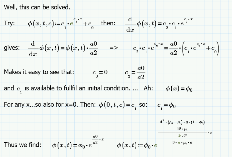

I'm afraid PDEsolve (real Mathcad) will not help.

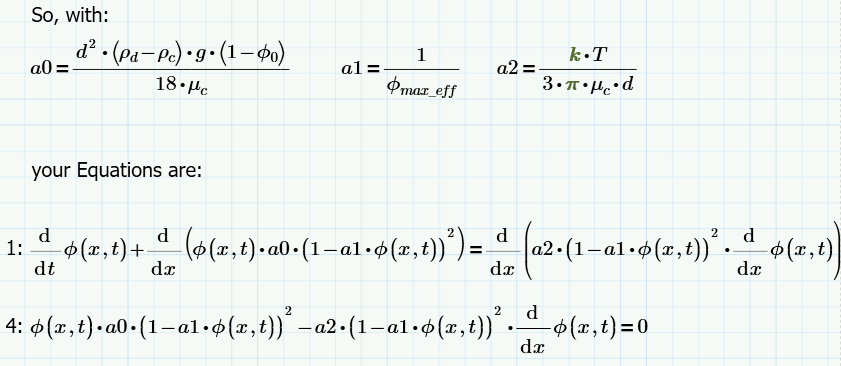

My results, analysing your equations:
Unfortunately, the coefficient of x in the exponent is positive, and large (about 23 million /m), which means that the function goes steep to infinity...
I don't suppose this accurately models your phenomenon...where did I, or you, go wrong?
Hi Luc,
            There is a slight confusion with your solution. The equation 4 that I had written is a modified version of equation 3 and is a boundary condition. Therefore I don't think phi (x,t) is independent of t.  The derivative of the expression may be 0 at the boundaries but not everywhere else. Volume fraction will change along the solution length as sedimentation takes place with time. I am attaching the mathcad file with my comments. Take a look.
Regards
LucMeekes
(To:arnair81)
I guess you're right, I mistook the "x ∈ {0, xmax}" (= just 0 and xmax) for an "x ∈ [0, xmax]" (=the entire range from 0 to xmax).
 Sorry about that.

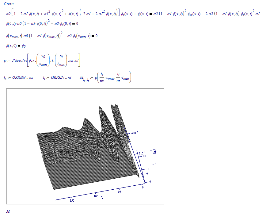

It may not all be correct, but this is what I get in Mathcad 11. I wonder if it's how you'd expect it to be:
The file is attached. You should be able to open it in Mathcad 15, and the part that is shown in the picture here should be similar.
The symbolics manipulations may not work in Mathcad 15, but you should be able to make them work with some tweaking.

Thanks a lot Luc. F9 sorted that particular problem.
The 3 d plot is slightly confusing. How can I plot phi vs x for a particular time t. The particle volume fraction should be higher at the base (x=0) compared to the rest of the solution after sedimentation. Please see attached image. If I can get a profile similar to that, then I think the model is a success. Thanks a lot for the help.

I should think that the attachment of my Mathcad 11 file today shows a plot of phi versus x at tp=20 h.
I was surprised that I got a result from pdesolve so quickly. Next I was surpised by the result itself, showing that the particle concentration at any given time would fluctuate over height, and realised that it doesn't match what the authors of the article found. That's why I hinted that I may have made a mistake somewhere. The authors indicate at some point that the numerical approximation is tricky. Maybe pdesolve is fooled and/or not the right tool for this problem.

What I am noticing is that the phi never reaches phi eff.max near the base. it is always around phi0. If I increase the phi0 value (lets say by 3 orders of magnitude or more), then it gives me an error saying that there is a singularity. I also noticed in the pde that the (1-phi (x,t)/phi effmax)^2 is missing. Maybe that can make a difference.
I don't know much about pdesolve to comment on how it might be getting tricked to give the wrong answer. Do you know why it can happen.

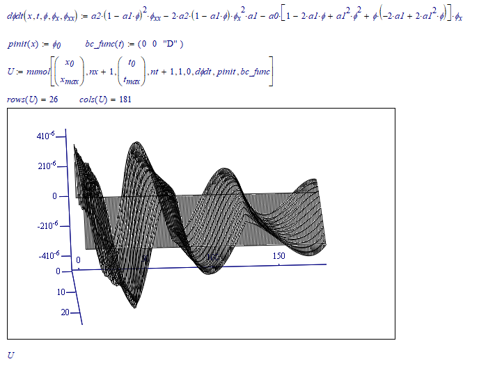

Anyway. I experimented a little with numol in Mathcad 11, and got this:
Note that I used the very same values as for pdesolve, a few days ago.
What struck me is the fact that phi goes negative here, which I attributed to the fact that your boundary conditions aren't exactly included (notice how bc_func only specifies 0's). I guessed they should be better added as a form of PAE (see help description) but so far have been unlucky in using numol with a PAE construct. And I'm not the only one. I searched this forum, and found no successful examples.
Then I experimented with more spatial resolution: changed nx from 25 to 250. The result is that the pdesolve solution now goes negative like the numol result shown above, but the numol result with that same spatial resolution stays mostly positive.
