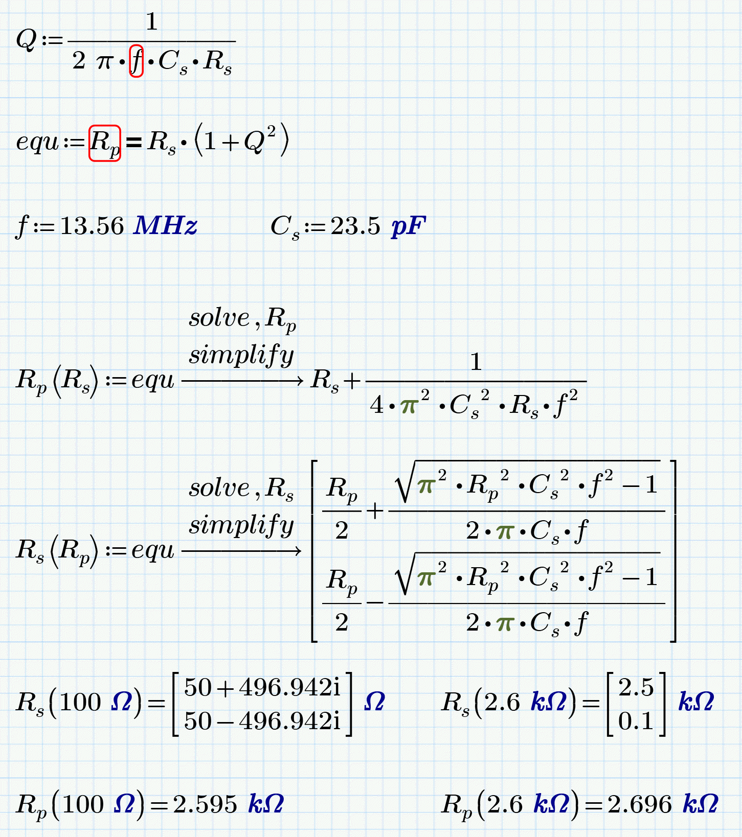

You are correct, the solve block will find a solution, but not the one you expect. If you look at the grayed-out section where we solve for Rs, there are two answers. If I turn that into a function, we get two real answers:
As with all math, "some experience required."

No reason to be scared. If you look closely you will see that in FM's attempt, both intial values of Rp AND Rs change. FM had set Q=3 for reasons unknown to me.
In my answer above I forgot to square Q.
Here's the correct equation and we get the results you expected and also both results for R.s if we supply R.p:
MF missed the square on Q

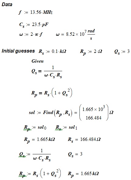

@Fred_Kohlhepp the spreadsheet you attached is okay for Rs computation but not for the reverse computation.
1/ Try computing Rp with Rs=9.9 ohm. It gives Rp=25.207kohm which is fine.
2/ Try computing Rs with Rp=25.207kohm. It gives Rss=25.2kohm which is wrong. Unless I didn't understood how to inject Rp and readout Rss.

The initial estimates (or initial guess) of the unknowns are the values that are assigned to the unknowns at the beginning of an iterative process that at each iteration approaches more and more to the solution based on the established tolerance. Once this value has been reached, the process stops and the calculated values satisfy the given equations. We have three unknowns and two equations and we know that the number of equations must be equal to those of the unknowns.

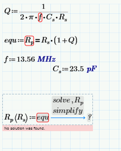

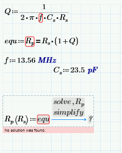

I tried writing the exact same in a blank worksheet and the first solve output is "No solution found".
Thanks for your time... I give up with Mathcad.
Chances are you have defined R.p above and assigned it a value.
Try the command clear.sym(R.p) before attempting to symbolically solve.
