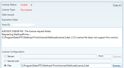

I purchased a student license for mathcad prime, but when I download my activation file and activate prime 11, even if the license manager says to be activated successfully, the program opens with the express version and says the release is not supported, version 10.0.1 works well.

open license file in Notepad.
The file must contain following line, if it contains Mathcad Prime 11.0 license
INCREMENT MathcadPrime ptc_d 11.0
Martin Hanák
Thanks for pointing this out.
The PTC Store currently advertises and sells Mathcad Prime 10 licences for students; it will change to be Mathcad Prime 11 licences sometime next week. You should be able to use Prime 10 as advertised.
The licence wizard saying Prime 11.0.0.0 has been licensed is a bug that I've brought to the attention of the product manager and R&D. They've logged the bug.
If you really want a Prime 11 product code, let me know and I can try to get you in touch with someone who can do that for you.
