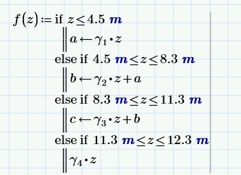

Hi
I want to create a loop that for the next interval add the results in the previous interval etc. I have made an attempt in the following program, but something is wrong. Any help is appreciated.

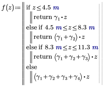

Maybe this is what you are looking for:
Because a "return" statement stops a program from running any further, you can also write

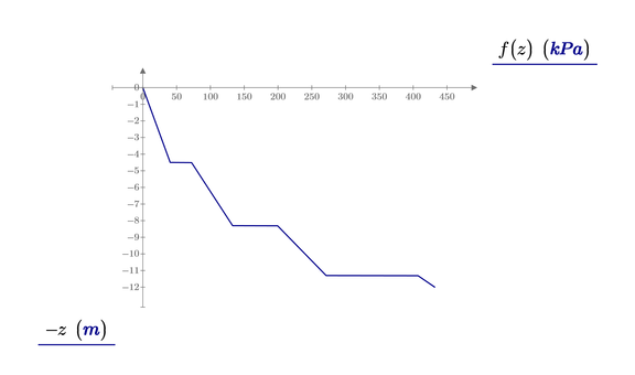

Prime 9 file attached

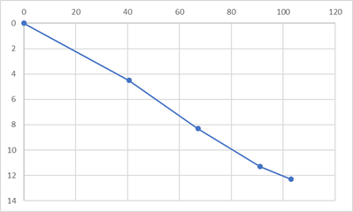

Not really, I want the diagram to look like this (Excel).
f(0) = 0
f(4,5) = 0 + 4,5x9 = 40,5
f(8,3) = f(4,5) + (8,3 - 4,5) x 7 = 67,1
f(11,3) = f(8,3) + (11,3 - 8,3) x 8 = 91,1        etc...
Hopefully you understand what I'm looking for 🙂
You are demanding now something different compared to your initial posting.
There your wrote " that for the next interval add the results in the previous interval etc." (and your function attempt also showed additios) and now you obviously want to subtract somehow?
In your program you wrote b <-- gamma2*z + a and NOT b <-- gamma2*(z - 4.5 m) + a
Maybe you can get more clear about what you actually need!

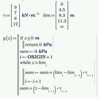

So far I guess that this could be what you are looking for:
(To:Werner_E)
Or you may use a more generic approach
Thank you, that's what I was looking for! 🙂
Very nice, I like that generic approach! That will be useful for me in the future, thank you!

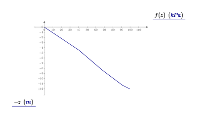

But this is really a simple integration,  Attached Prime 4 Express.
(Extension to the second problem, above the water) will require definition of sign conventions.
😉 Its only simple once you found a way to automatically choose the correct gamma-value for every depth, like you did with
