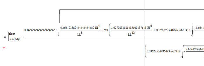

I tried to solve an equation symbolically. I dont know why it doesnt work. The solution must be simple, same as the numerical one with one extra unknown. Can someone please take a look. I tried different methods.
You may use the modifiers "float" and "simplify" to see, that the result sure isn't so simply like you think 😉

You forgot to specify the number of decimal places for the symbolic operator "float, n".
(To:VladimirN)
No, I did not forgot, I was lazy and used the default (which is 20, if you don't specify a number).
BTW, its not the number of decimal places but the number of significant digits.
