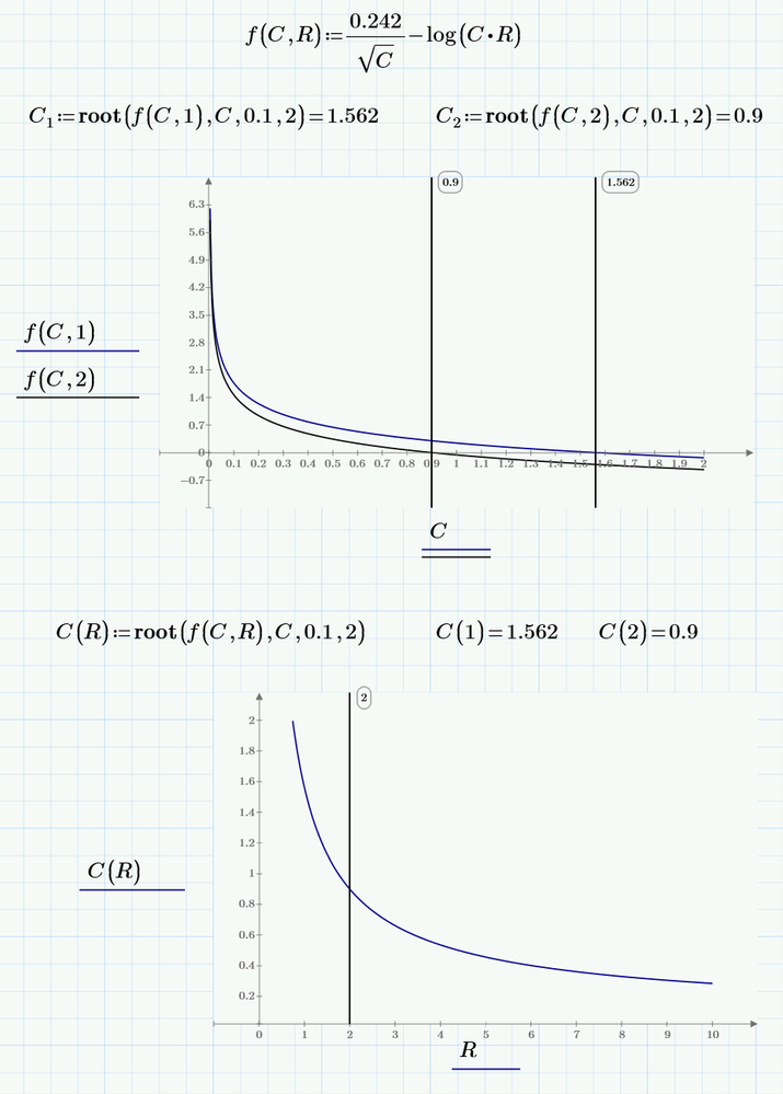

You can use not symbolic but numeric math

The native numeric methods provided by Prime are the "root" command in its two flavours and the solve block with find. They will give you a numeric solution which also means that you will have to provide a value for R. Valery had shown how to set up a function which returns the C-value for every value of R.

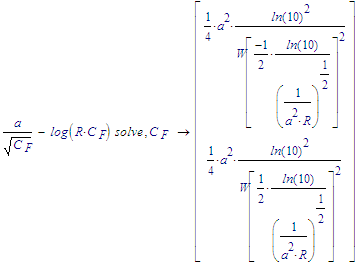

Simple for Mathcad (11):
Note that:
- In your problem a = 0.242, I did not use that number to prevent a floating point result with a ridiculous number of digits.

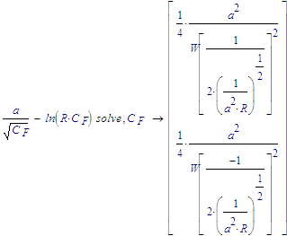

- the function 'log' is the logarithm with base 10, if you intended the natural logarithm (base e), use 'ln' instead. The result then becomes:
- You get two possible solutions, possibly due to the fact that R and a could be complex numbers.
- the solution uses the function W(z), which is the Lambert W function which is the solution to a specific equation:

Chances are that 'the alternative symbolic engine' of Prime 6 will find the solution with the Lambert W function.
Finally for a given (suppose) R=1 only one solution is found (a and R are now both real numbers):
(or, for the natural logarithm:LucMeekes_0-1598430750092.png)
