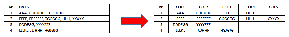

Hi to all.
I need to generate a routine that separates into columns texts that contain words separated by a comma "," as shown in the image.
Is this possible? Thanks in advance

@BPP wrote:
Hi to all.
The answer is yes, although it may be more challenging in Mathcad than some other programs.  If you have to do this only a few times (and can allow a "manual" method) I'd suggest (in Prime) an EXCEL component:

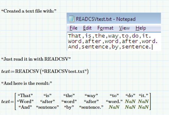

What's wrong with using READCSV ?     (Read Comma Separated Values)
Otherwise READTEXT could be your friend.

I thought I'd better try it out:
Prime 3.1 file attached.
Luc:

Normally to manipulate text I use excel, but I had doubts if there was a way to do it directly in mathcad, exactly as LucMeekes proposes, with READCSV, I did not know that command.
Thank you very much for the help.
