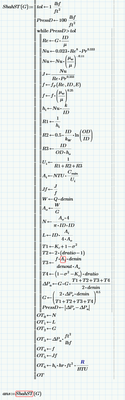

Even though the function is defined when doing ans := ShahST(G), MATHCAD says its undefined.
Please advise.
Thank you in advance.
Attached is the solution to the issue, as I was missing vectorization on OT and wrong caps on Nu.

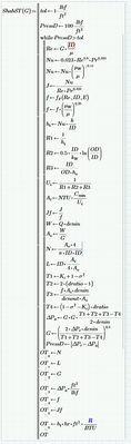

Found the issue.
