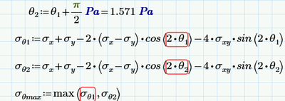

Appreciate if anyone can help to solve the units issues in the attached file
Try this one enclosed.

Please consider this one:
Thank you so much sir👏

You mean this:
It is very clear. You CANNOT have units (other that radians, or degrees, which are essentially unitless...) in the argument to any of the trigonometry functions.
