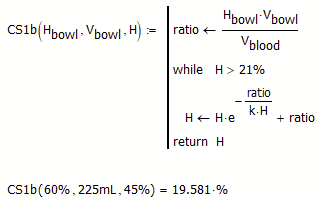

This is most likely a very stupid question but I do not succeed in this simple program. Attached is a MC 15 file I would like to automate in a small program the process mentioned in the highlighted comment. Would anyone be so kind to help me out as I do not "see" it right now.
(To:FDS)
OK, here is the all in one version
Or a bit shorter:
And in case that you also need the intermediate results, here's a way to get them:

Hct.cyclestart should be replaced in eq. 6 and 7 but not in eq 5, which you wrote after eq. 6 and before eq. 7? Are you sure?

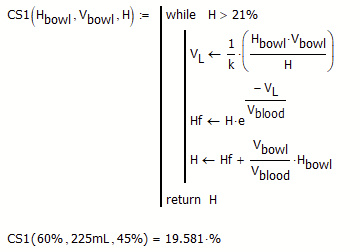

Obviously you'll need to use a "while" loop to do the iterations.
Why don't you make k and V.blood an argument of function CS, too?
(To:Werner_E)

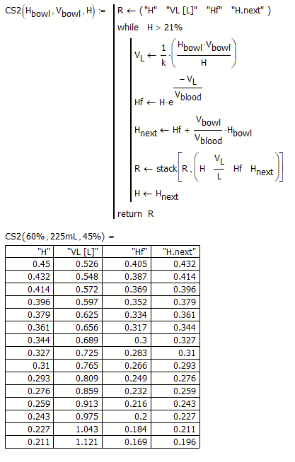

Here is an approach using your function CS, assuming that the value in eq.5 has to be replaced, too:
Of course its not mandatory to split the calculation into two functions. I was simply lazy 😉
MC15 worksheet attached

Werner I must have had a complete blackout... but you made my morning. Thank you for your assistance.
