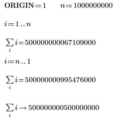

I have very basic questions and problems with summation operator. Please see the attached worksheet for examples. First question, I'm not just able to understand how the high lighted sum (13) is calculated?
Second example is shown also in the worksheet. How would you use the summation operator so that you could prepare worksheet template and define the n in the beginning of the calculation and then the formula adapts with the amount of n? I mean so that you don't have to change the formula by hands every time the n changes?

Enclosed worksheet answers your questions.
Remember worksheets operate left to right top to bottom in defining equations.

A good example for a beginner is that rearranging the terms changes the sum. In numerical, not symbolic mathematics.
Hi! Sorry for the delay but thanks guys! I got what I wanted and got my work to proceed. Thanks again. BR Harri
