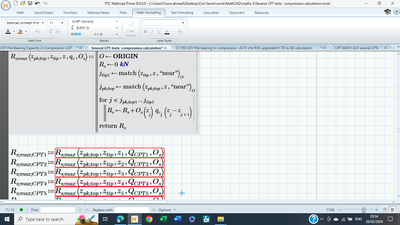

I have six tests and I have done the calculation for one test I need to do the same calculation for the remaining five tests and I don't want to copy paste the calculation, I want to use the same sheet for all the tests with enabling all the functions and calculation to change according to the input values ( general calculation). For example, I want to use the same program for all the CPTS
Can you help with that 🙂
The sheets are attached
