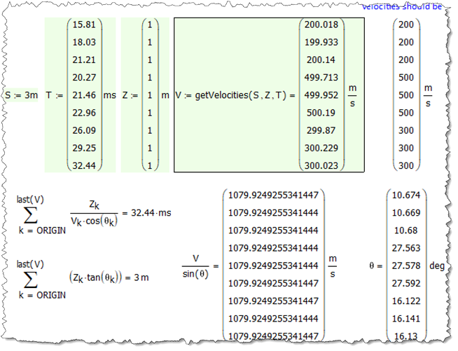

OK, I couldn't resits 😉
Here's my approach. Looks like the values are close enough to the one you expected and all conditions should be fulfilled. You may even use "Find" instead of "MinErr".
The use of the predefined guess vector for the angles isn't really elegant but the alternative would be to create a suitable guess vector of the correct size before calling the solve block function and add it as additional function argument.
I guess you are only interested in the velocities and not in the various values of the angles in each iteration step. If you should need all the angles, it should be easy enough to collect them in a matrix and return them as well.

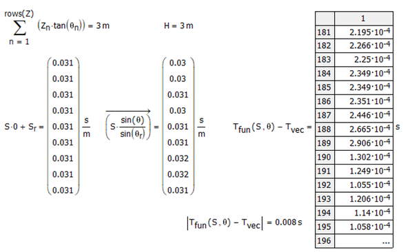

Thanks, Fred -- I should have been more specific. This is an iterative calculation where I am attempting to find a vector of angles (theta) that is compatible with a vector of slownesses (S). I originally tried the approach you are showing, but it does not converge (see attached). Note that, in reality, I would wrap this whole thing up in a loop with a convergence trigger to jump out, but for just looking at how the first few iterations of the calculations progress, I am just copy-pasting.
Thanks again.

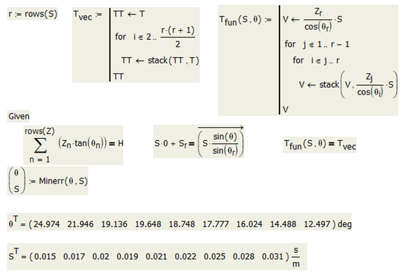

Haven't looked at the last sheet you posted and just tried to make the solve block in your first sheet working.
Not sure if the following would do the job. I am not proud of this crude solution and hope someone is able to find a more elegant solution.

Thanks for having a look Werner -- pretty slick way to get the solve block working. Unfortunately, the solution you obtain is quite far from the true solution, shown below. What's odd is that the first set of constraints (the sum) is well-satisfied, but the second (the equality) is not.

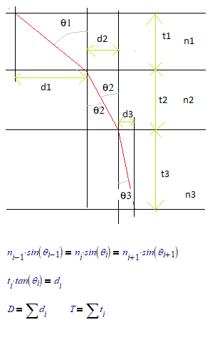

LucMeekes
(To:MoeSzyslak)
So is this essentially your problem description (where I'm unsure about what are the knowns):

As far as I can see all constraints are pretty much fulfilled to a certain degree.
Its surprising how quick the solve block solves and why changing the values of TOL and CTOL don't noticeably affect the result. Furthermore is Levenberg-Marquardt the only algorithm which finds a solution, the other two (conjugate gradients and Quasi-Newton) fail.
Which are the additional constraints you'd like to add?

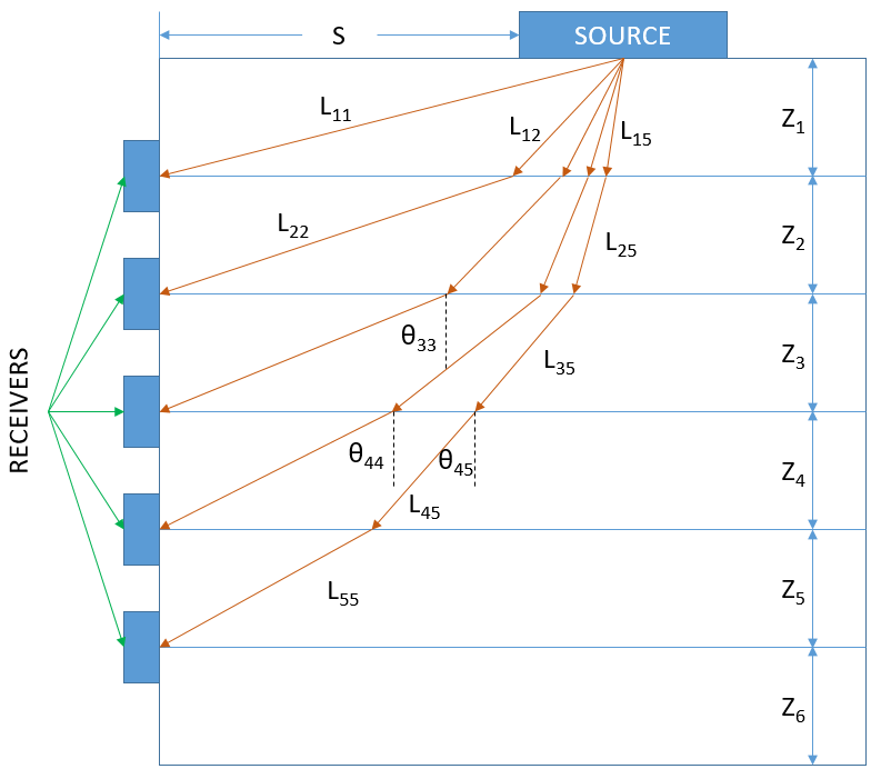

Hi, Fred et al. --
The layer thickness is 1 m, but the horizontal offset of the signal source is 3 m. In general, of course, these values are arbitrary.
I have attached an image of the problem geometry. The problem isn't changing, I am just not going a good job explaining it. I had hoped that I could solve it in one way when I started this thread, but now I am pretty convinced that way won't work. So I have re-cast it a couple of different ways in hopes of better explaining it, but I have served only to sow confusion.
In the attached figure, We have a wave source on the surface and some receivers on a vertical line some horizontal distance away, S. The travel times from source to receivers are measured. In the first layer (V_1), the wave velocity (or slowness) may be calculated directly. That velocity is then used to calculate the wave velocity in layer two (V_2), which requires the knowledge of the refraction angles q_12 and q_22. Thus, the problem is now iterative. Once V_2 is known, the calculation is continued for subsequent layers. In the figure, X_ij corresponds to a property of the jth raypath in the ith layer where X is some quantity (length, angle, etc.).
Does this make sense?
Thanks.

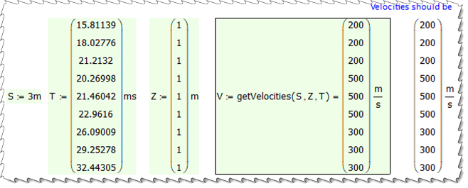

BTW, is it possible that the time values you posted are a bit inaccurate 😉

This is fantastic, Werner -- very ingenious.
Yes, the time values were imperfect -- just some synthetic numbers to test the algorithm. I'm going to give it a go with some real data.
