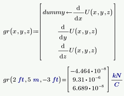

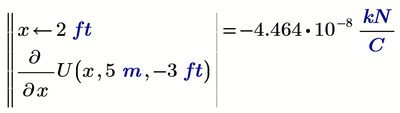

What you experience is a new bug in Prime 10 with derivatives of functions with more than 2 arguments.
A workaround I found is the addition of an assignment
Actually it does not matter if the assignment has anything to do with the function and its arguments - any dummy assignment will do.
The very same applies if you use the Nabla operator to define the function

Good morning Wener and Terry,
the solution that best worked in my spreadsheet was the one using the dummy assignation on the first derivative.
