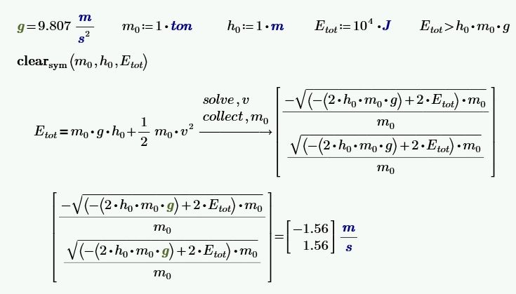

(To:Rudemberg)
Here is what I get in Prime 6, using the new and the old symbolic

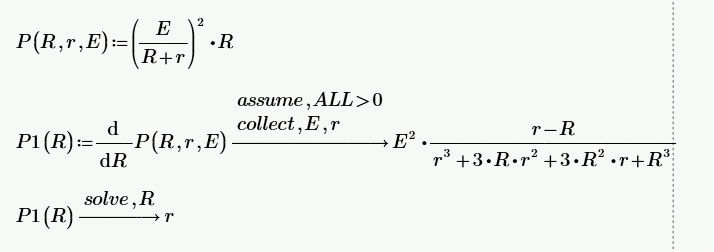

I do this way:

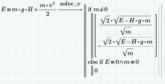

a way to solve the problem is the following:
