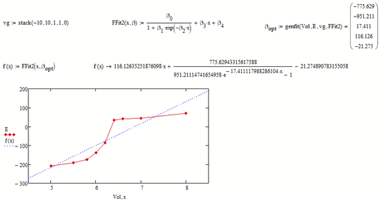

The error message says the number of fitting parameters and guess values must be the same, but they do !!!
Please, take a look to the file attached, this is a short programm.

Not exactly sure what you mean by "The combination of these three functions gives a family of non-asymptotic sigmoid functions". Which kind of "combination"?
If you have a simple additive combination in mind, you would have to do it that way, nut the result sure is not satisfactory (and very sensitive wrt the guess values):
But if you want to say that you would like to split your curve into three parts and fit a different function type to each part, then you would have to do the splitting yourself and fit three times.
BTW, Here's a function which seems to fit your data pretty well:

Yeah, I was talking about "linear combinations of functions" , sorry.
Thanks, you helped me to fix this error, now I can fit with genfit.
I think mathcad is not good for fitting points if they are not well close to a mathematical curve, but experimental points are random up and down from such a curve.
I was hopping to fit experimental points to non asymptotic sigmoid curves like this https://stats.stackexchange.com/questions/398551/logistic-function-with-a-slope-but-no-asymptotes
(because some chemical law predicts this) you see there are 5 paramenters, I also added a sixth parameter x0  in this form: instead x I put (x-x0) hopping the fitting process could find the best x0, but the outcome was ugly.
SigmaPlot can fit this without problem (sorry for comparison) but at the moment I haven't this software.
Thank you anyway.

Mathcad often is very sensible with respect to the guess values which will have to be chosen with great care.
You may want to have a look at the eval version of CurveExpert Pro. Even in demo w/o the various export options mode its quite useful for curve fitting. It has a lot of predefined function types which it tries on the data and you may also define your own.
