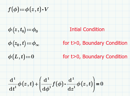

         I am trying to solve the Kynch sedimentation process. For that, I need some help solving PDE with certain initial and boundary conditions. The objective is to get volume fraction (ϕ) in terms of height (z) and time (t). I am not really sure on how to go about doing this. It would be helpful if someone could take a look at it.

       I have followed the equations given in the paper. Kindly check the attachments.
LucMeekes
(To:arnair81)
To my opinion the paper uses inconsistent formulation.
At one time f is a function of just phi: "f(phi)".
At another point it is a function of two variables: "f(0,t)".
Mathcad, nor Prime will be able to work with that.
P.S
In your usage of Prime, with the derivative, you can leave the 'order' of the derivative blank if it's just 1 (It's only needed for second and higher order derivatives). That 'll help with readability.
           Since df(ϕ)/dϕ=V, can I just put V*dϕ/dz instead for the second part of the equation. Will that help? Other than that, I am not really sure on how to proceed.

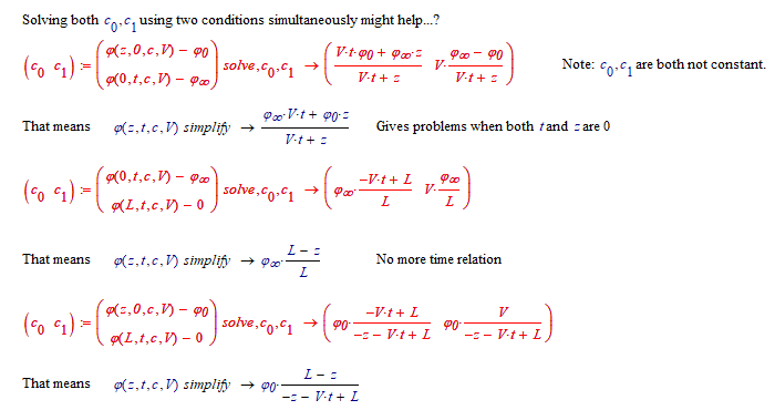

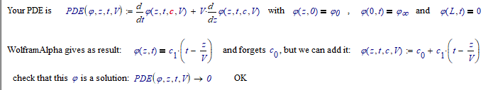

I thought I'd better try is symbolically...:
So we have an expression for the function phi.
Now from here you should be able to solve the two remaining constants a[0 & a[1 and subsequently find out if this function describes the behaviour you're looking for.
Luc.

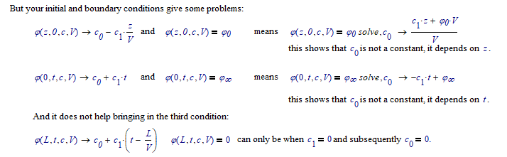

Hmm. I can only hope this helps:
But none of these phi solve your PDE anymore !
    So if none of the phi values solve the PDE, then it means that it is probably not the solution. That's a bummer. That kind of leaves me a bit stuck.

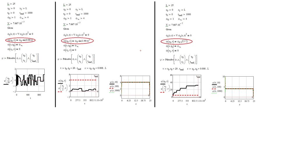

-MFra-
(To:arnair81)
Below are my attempts to find a particular solution, using MAthcad 15, to the equation, after having defined the boundary condition for ϕ:
