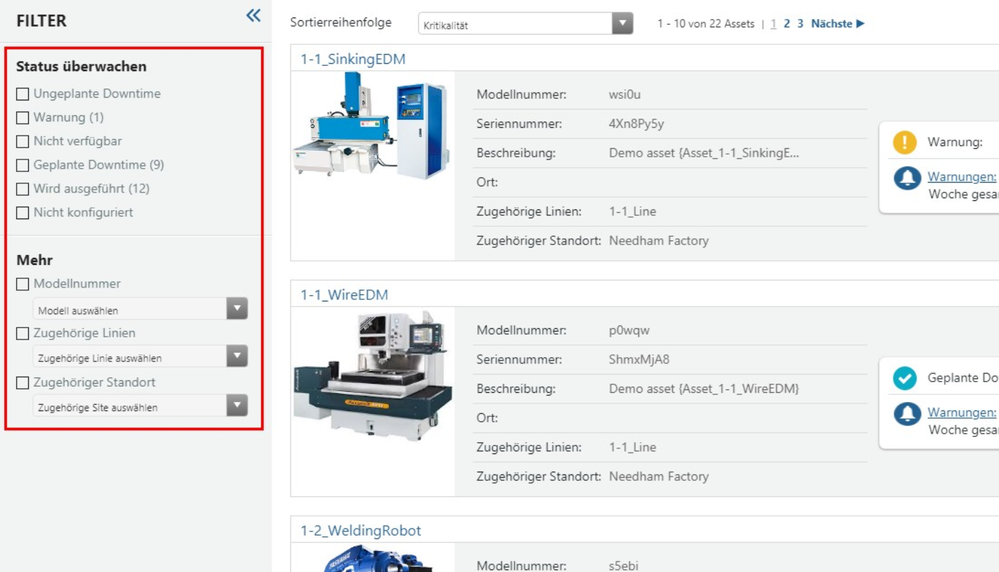

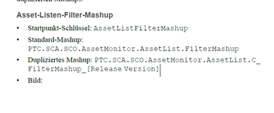

Now I want to add the new properties as filter-options for assets. The documentation says I have to edit PTC.SCA.SCO.AssetMonitor.AssetList.C_FilterMashup_8.4.2_00 for that.
Like in the picture from the documentation I would like to add new options under the category “Mehr”. I want to add MashineType from PTC.ISA95.PhysicalAssetThingTemplate.

You need to add more filter options like Model Number and dropdown box. You can do this by adding widgets in the mashup and adding the relevant services for data values.
Also you need to update AssetListFilterMashup value to your updated mashup in the configuration of Launchpoint Configuration.

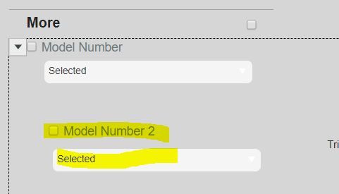

Hey @hchanana thanks for the fast answer.

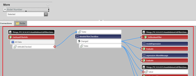

I added Mashine Type and also a dropdown box for it to the AssetListFilterMashup.
My problem ist more how to link the properties to it like in Model Type and the dropdown box for it.
Do I need to add the Thing with the new properties to Data on the right side of the mashup? It´s a bit hard to try to rebuild exactly what you did with the Model Typ and dropdown widget but for Mashine Type.
Maybe there is a detailed documentation with a step to step manual?
Normaly the "TW_manufacturing_apps_customization"-manual helped me with every problem I had, but this time there is just a "what to edit for which option" not a "how to edit".

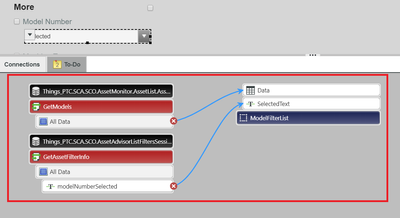

Hi @Keffler ,
Yes, you need to add the Thing and service in the right side of mashup. The output of the service should be passed to dropdown list.
You can refer GetModel service in PTC.SCA.SCO.AssetMonitor.AssetList.AssetFiltersController thing which is used for displaying asset model value in dropdown box.

Hey @hchanana,
sorry for texting you again, but I still have some problems with my task to add new filter-options.

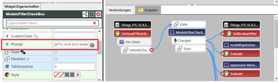

1.
When I go to ModelsFilterCheckBox for modelnumber there is the propertie T Prompt to add a name. In the checkbox for modelnumber it is [[PTC.SCA.SCO.ModelNumber]].
I can´t find something like that for my new propertie machineType. How can I create something like that to add it to the new checkbox?
2.

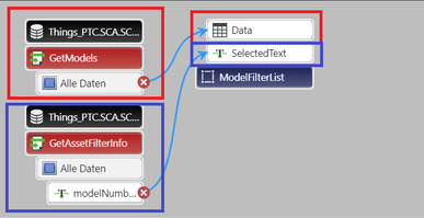

Also I don´t know how to configurate the widget under the checkbox correctly. It´s conected to PTC.SCA.SCO.AssetMonitor.AssetList.AssetFiltersController over GetModels, all data to data. This was easy to build for the new one. (red in the picture below)
But there is also the conection from PTC.SCA.SCO.AssetAdvisorListFiltersSessionHelper over GetAssetFilterInfo, all data, modelNumber to selectedText. And there is my problem. There is no machineType in GetAssetFilterInfo for the selected Text. (blue in the picture below)
I know, that this is also pretty new for you, because the manufacting apps are new, but maybe there is a way to help me out with my problem? :)
