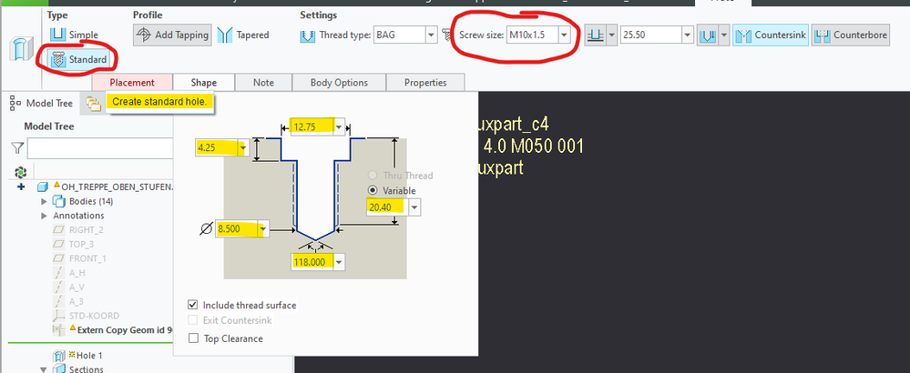

@Ertan_AkbayirIt sounds to me like you're not using a standard borehole table? Once you have defined them, all dimensions are stored and you only have to choose the right size. If necessary, you can also create your own table (in out case BAG for thread type).
