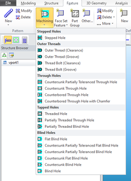

First of all, all the holes have to be done with the machining feature, to the addon that create the table be able to identified them.
In my case i have some tolerance holes, to do that i used a addon that i have that is SolidPower that allow me to set a tolerance to a hole

Now, we move to the 2D. Im gonna use the same base for example.
To  create the hole table i use the same addon that i use to create the tolerance hole, SolidPower.
You need to:
-Choose the view
-Reference Point ( Part origin)
-Table position point
Aftter that click draw numbers to number all the holes to be identified in the table.
Final step is to draw the table.

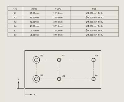

I want to create a 2d drawing of this base  (1st pic) with all the holes.
Normally in this type of drawing all the holes are identified with numbers or letters, and in a table (2nd pic) the location of the hole is identified with the X and Y position from a reference point.

Basicaly i create a CAD model, a base plate with several holes, inlcuded threaded ones. After that i need to create a tecnical drawing to be able to send the base to the production sector, to be machined.
As i said in the inicial post, i have 0 experience with this software, and i dont even know how to install the macro or even use it.
Im really surprised because this is a feature that every major CAD softwares have (SolidWorks, Inventor...), and in Creo i have to create a macro to do this.
Below is some pics oh my screen, because i dont even know if we are talking about the same software 😅.
I blur some parts in the picture only for privacy purposes.
