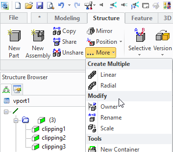

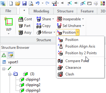

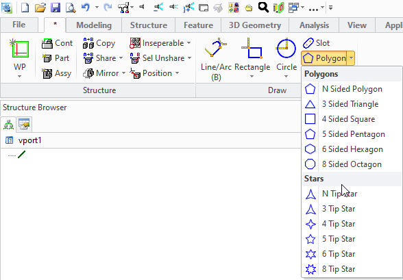

I am making 1 tab that contains all the functions i need on a regular basis. And one that relocates my most used functions to the foreground. I wanted to create named seperators like the standard menu does. But I can only find the boring old line seperator.
Is there any way to give my custom split menu a nice looking format like standard? Or is that something that is reserved for the base program?
▼What i've got so far▼
▼What I want▼

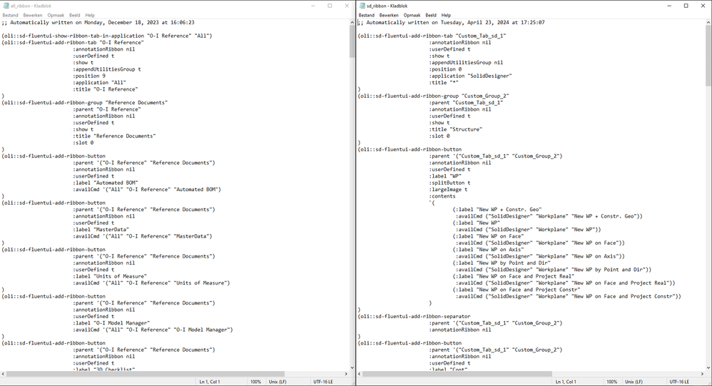

I placed your all-ribbon.LSP file in my customisation folder.
Since my customised file was named sd_ribbon, it added your tabs in adition to my already existing custom tab called *
However all the commands were greyed out. ▼
Here is a screenshot of my LSP file next to yours
Left▼ Your custom ribbon saved in all_ribbon.LSP                                  Right▼My custom ribbon saved in sd_ribbon.LSP
The main difference I can spot is that you call out "O-I Reference"
I suppose this is either a module we dont have, a feature from a future update, or something you custom made.
Whatever it means, your ribbon doesn't quite work for me.
Only the 3d spiral seems to work since its defined as follows:

In addition to Tom's excellent suggestions, if you've been experimenting a bit, you should have an all_ribbon.lsp file in your user customization directory (usually something like "C:\Users\<username>\AppData\Roaming\PTC\Creo Elements Direct Modeling 20.1\20.1\all_ribbon.lsp). to use as a starting point (and as Tom says, make a backup before you start playing with it). This file will be loaded every time you start Modeling.
Note that you will need to restart Modeling each time you edit the file to pick up the changes.
You can use the (:label "My Separator") idea in any of the :contents sections as you experiment. For example, when you first open that file, the area where you currently have your separator (which will be in the middle of a (:contents ....) section) you should see the line (:separator t) -- you can replace that with (:label "My Label"), to get the behavior you want..
Good luck -- this stuff can be fun!

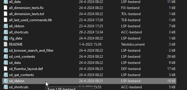

One thing that was slightly different than what you explained was that i had a different .LSP file for my ribbon.
The file is called sd-ribbon.LSP. (presumably after "SolidDesigner") After I added the named label to this file as you suggested, I got the results i needed.
The all-ribbon.LSP contains just a group i made months ago that i added to the standard "Modeling" tab.
Maybe it has something to do with calling the group " * "
Is there any downside to having this be a different LSP file?
