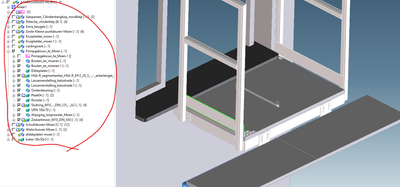

I am using creo elements/direct modeling version 20.6. I have noticed that it's still not possible to open a drawing straight from the model tree. Would it be possible to write a script or custom command to do this? Because now you have to go to the masterdata first and find the drawing there.
Other solutions for this problem are also welcome.
Kind regards.

I will try and explain what i want to do. I used to work with autodesk inventor. In that software i could right click on a part/assembly in de model tree (see screenshot) and click "open drawing" and it would open the drawing that was linked with that part/assembly. I would like something like this for creo elements/direct (if it is possible though) either with a custom command or macro or something. The way we do it now is get the masterdata from that part and open the drawing from there. I could save a decent amount of clicks if i could open the drawing directly from the model tree.
I hope this is a bit more clear as to what i wanna do.
Kind Regards

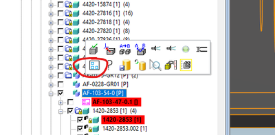

Just add it to your popup menu.
Creo Element\Direct Modeling 20.6.0.0.0
How do you make the menu appear?
HOLD UP THERE THOMAS!
Is this a custom LISP you made? Because i could not find the icon from your screenshot in the list of all commands. Is it a command from windchill? (since we still use model manager it would explain the absence.) And if it isn't, could you share how to add this functionality to direct modeling? It would be an incredible quality of life upgrade for me and my colleagues.
Thanks in advance!
