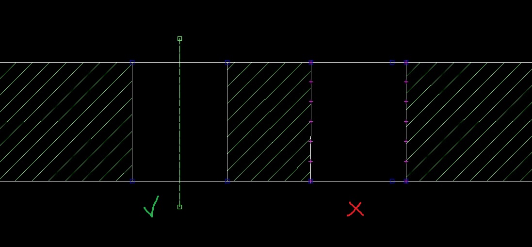

Hole axes
AR
11-Garnet
11-Garnet
Hole axes
It doesn't put the hole axes in the side views or sections
Why?

highway45
(To:AR)
Perhaps the part or the holes are not 100% vertical/horizontal in 3D room.
Or the section views have very small deviations in view angle.
Zoom into it and switch on the edge points (shift+F7).
Pink colored little crosses indicate if something is wrong.

AR
11-Garnet
11-Garnet
(To:highway45)
the holes are perfectly perpendicular...isn't it some setting in the sections???
AR
11-Garnet
11-Garnet
(To:AR)
ould it be a resolution problem of the piece?
is it possible to increase the resolution?
der_Wolfgang
(To:AR)
The default setting to create those lines is available for  "Add symmetry and centerlines to standard views during view update."  => see settings browser.
a) afterwards it can be enabled / disabled per view. (-> view properties)
b) it also depends on the view-profile which was used when creating the view  / or applied to later on.
BTW  1..2E-1 mm is a rather poor resolution for a system used to use 1E-6 mm. But it the section is defined correctly (center of hole, perpendicular) it should work as well.
