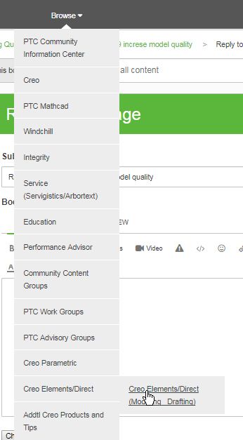

In the future, post questions about Creo Elements Direct Modeling here to make it easy to find.
