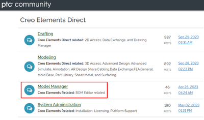

If you want to automate this maintenance of your drawings and not lose track in large assemblies.
You have to purchase additionally a database program and that is for example the Model Manager or something else equivalent.
I can't explain much about Model Manager, because I don't have it.
