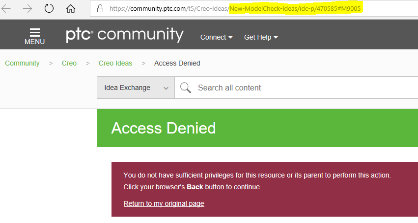

TomU
(To:DomenicLaritz)
It seems like it still exists but is locked behind some type of wall.  Maybe @Jaime_Lee can help figure out why...

Jaime_Lee
Community Manager
(To:TomU)
Hi, @TomU
Thank you for bringing this to my attention.  Creo Ideas are under review.  I will have to address this after the content remapping is complete.  I have this issue bookmarked.
I still can't find the specific forum for ModelCheck.  I did a search for it and all the posts seem to be scattered in different forums.

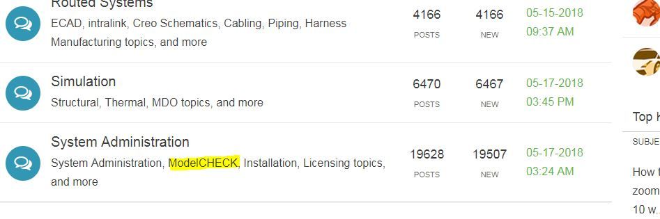

dgschaefer
(To:STEVEG)
ModelCHECK is supposed to be under system administration, according to the descriptions under the main Creo Parametric page:
https://community.ptc.com/t5/Creo-Parametric/ct-p/creoparametric
If you're asking about the ideas page, I'm not sure.  It got moved somewhere while they sort out the new ideas page(s), but the link that @Jaime_Lee posted in the Community Refresh section (not open to all) was broken and she hasn't posted a corrected one yet.
