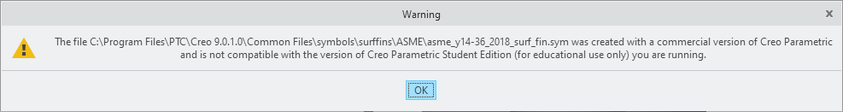

Hey!
Whenever I try to open the symbol gallery I get the following message from Creo (see screenshot below). After I hit OK the program just simply crashes. I am running Creo 9.0 Student Edition.
Has anyone experienced the same issue before?
Thanks for your help in advance!
Please run setup.exe on your computer, choose reconfigure and license again using this code:
BE900908EDSTUDENTEDK12
After the process ends, you will be able to open all the symbols.

I have the same issue with surface finish symbol with CREO 9.
How could the problem be solved?
Thanks for answer.
Bye

Thanks very much Alex.
With the code you give the problem is resolved.
