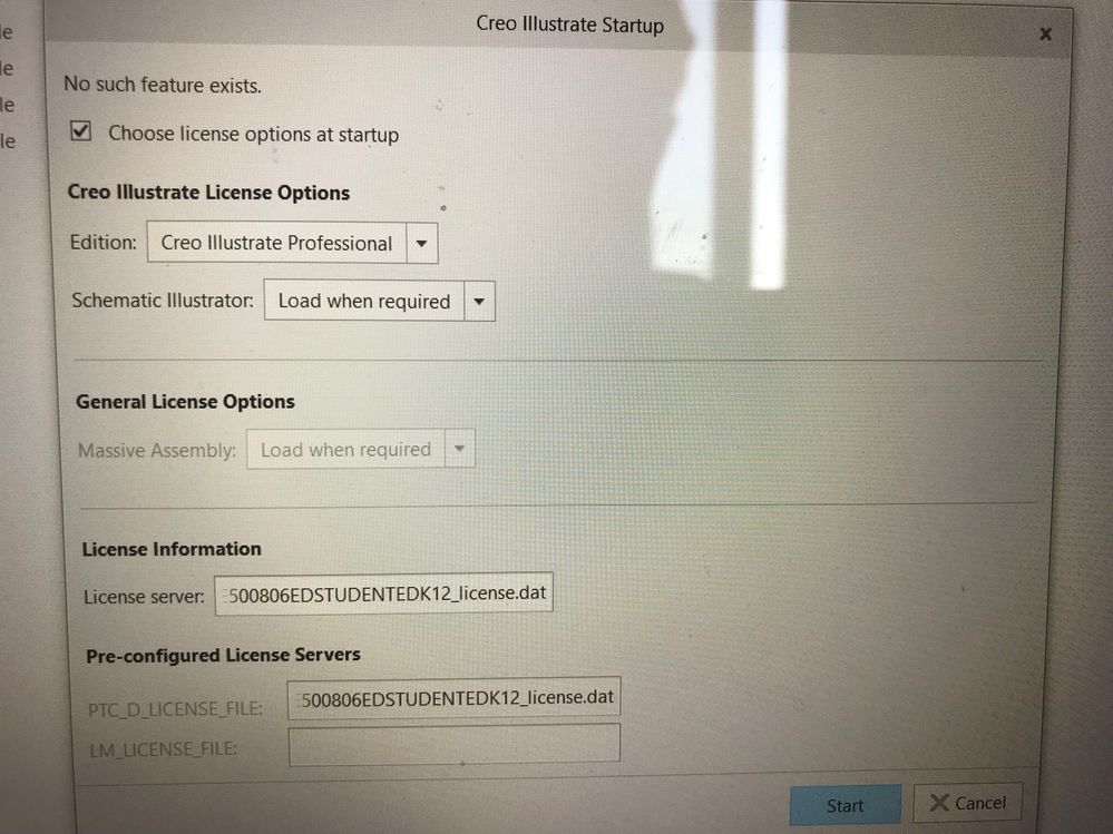

We got the premium license codes for Creo5.0 and installed. BE500 number. Then we downloaded Creo Illustrate 5.0 and then installed. At the start we got this screen and we gave the .dat file which was generated in C:\ProgramData\PTC\Licensing\filename.Dat and tried starting but no such feature exists.
Attached here with is the screen shot. Can you tell if we are using correct license server?
I tried changing to Creo Illustrate Standard also and it was giving the same error.

No, this is't the right license. The license you are using is for Creo 5.0 Schools Standard Edition. You cannot install Creo Illustrate with this license.
You will need to purchase a license of Creo Premium from the PTC store https://store.ptc.com to install Creo Illustrate.

Finally I got it working.
Steps:
To make everything work we need to use Setup.exe and not the SetupSchool.exe for Creo5.0. I used the Premium license codes for school which start with BH500..
This will create a BH500....dat file in c:\programdata\PTC\Licensing\BH50.......dat file
Complete Creo installation.
Install Creo Illustrate and when Creo 5.1 is opened it will point to the same .dat file. Use this file in the license server ->click start and the popup box disappear with Creo 5.1 illustrate screen.
I did unintall and install almost 5 to six times to get it working.
