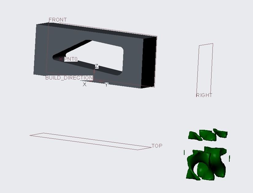

The final output ist a minimal surface body deformed and not even attached to the part.
Before:
After:

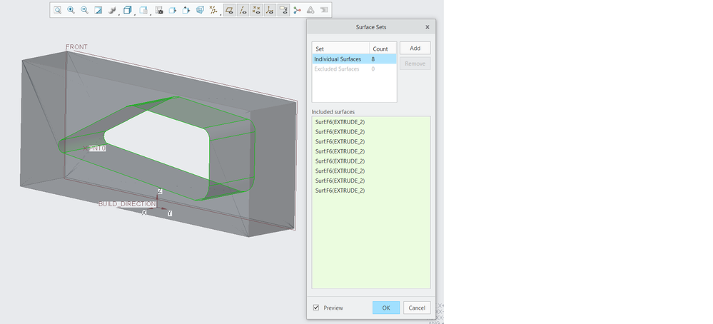

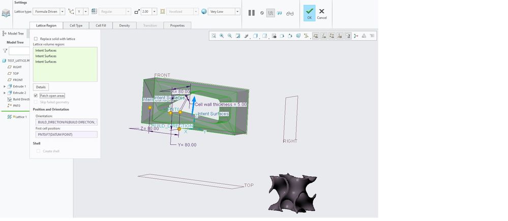

What surfaces do i select:
First I select the inner surfaces like so:

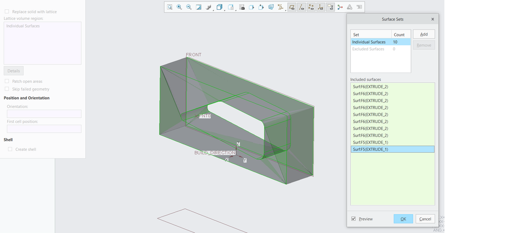

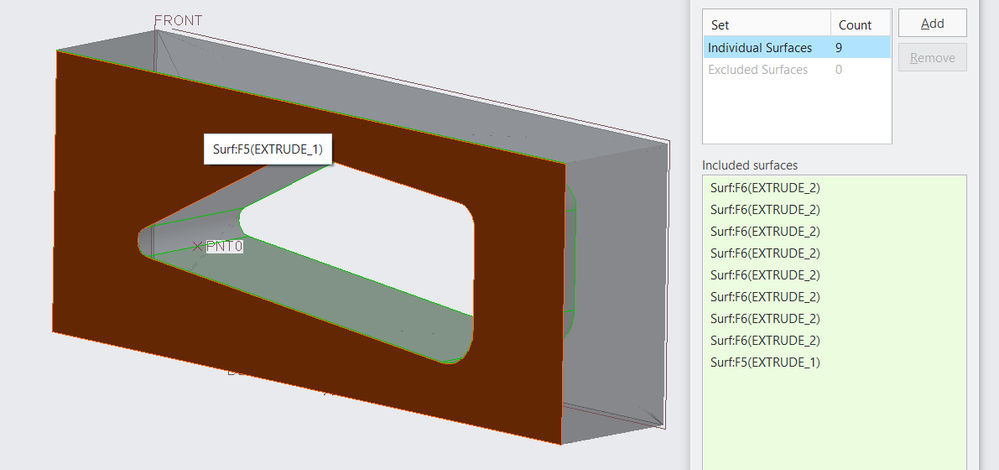

Then I select the outer surfaces normal to X-direction on both sides (in the picture one of them is highlighted)
Final it looks like this:

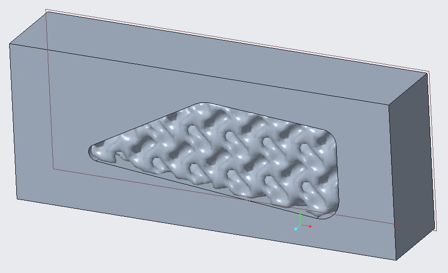

Other lattice types work well with this surface selection.
See here:

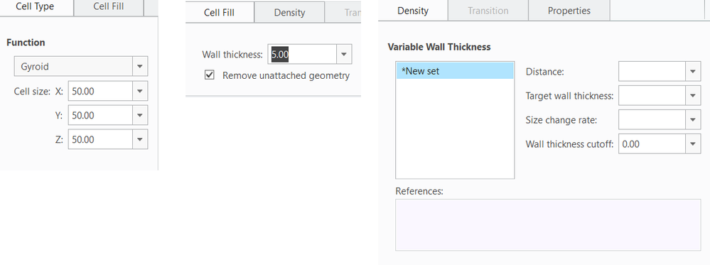

If I switch to e.g. a Gyroid the cell moves to my initial coordinate system regardless of my selection of orientation.
The following parameters are used:
Does anyone have an ideal to overcome this bug?

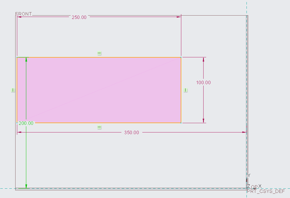

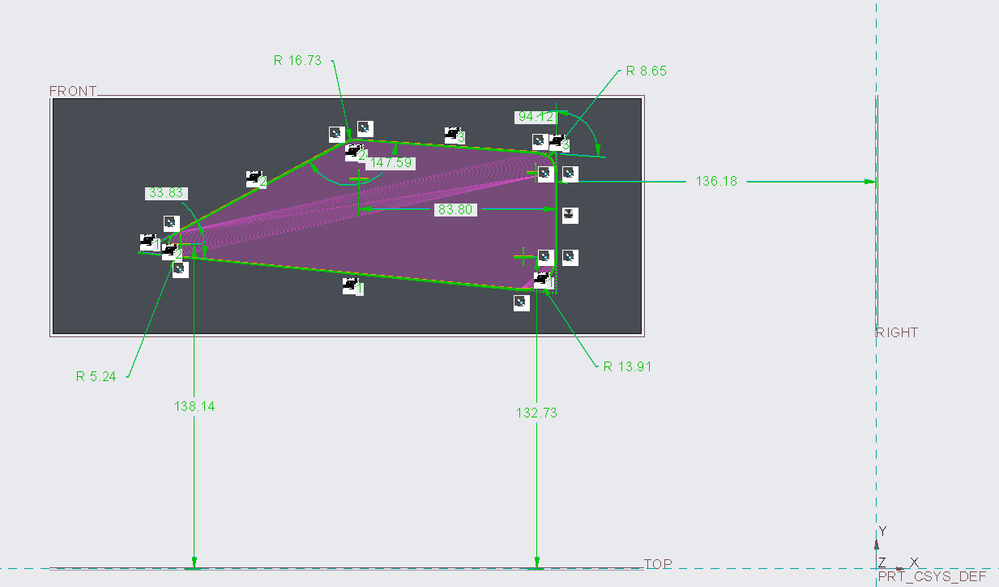

if you cannot upload the model, then (I hope) you can attach picture of Extrude section showing its shape and dimensions. Also you can publish the depth of Extrude feature. This information enables me to create a copy of your model. What do you think ?
Yes sure,
The thickness is 50mm. All dimensions in mm.

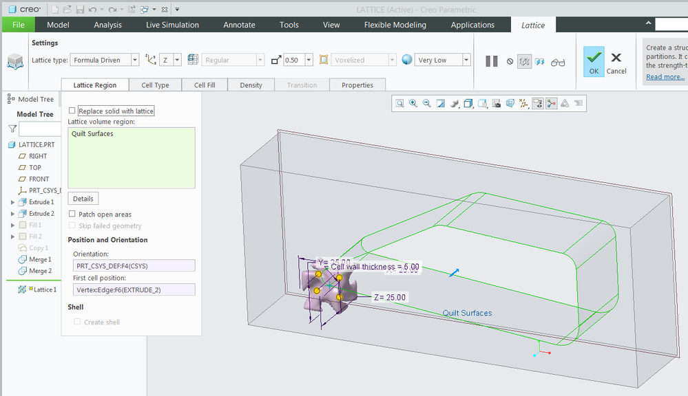

1.] I created closed quilt representing area you want to fill.
2.] I selected the quilt as Lattice volume region
3.] I finished lattice feature
I used Creo Parametric 6.0.2.0.

Hi multigrid,
The reason you can't generate the lattice is that you are selecting the STL surfaces, as you used the Additive MFG Build tools before the lattice creation. You could try to do the Lattice before selecting the build direction.
