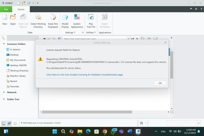

This problem faced me when i tried to open the creo cad
Nov 11, 2024
04:17 PM
- Mark as New
- Bookmark
- Subscribe
- Mute
- Subscribe to RSS Feed
- Permalink
- Notify Moderator
Nov 11, 2024
04:17 PM
what is the solution????????

What version of Creo are you trying to use?

license file mentioned in the picture belongs to Creo 10.0 -AND- you started Creo 11.0.
Please read https://apps.ptc.com/schools/references/install_creo11_schools_standard.pdf document carefully.
