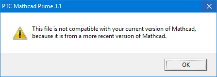

If you open in any version prior to Prime 4.0, you should get the following error:
Prime then opens a blank worksheet for your use, but it is not attempting to open the specified file.
PTC has decided that files should not be backwards compatible, so older versions cannot open files form newer versions, and newer versions cannot even save-as to an older version.

In Prime, like many other products, early versions (2.0) cannot read later versions (3.0, 3.1, 4.0).
In Prime, unlike other products, later versions (4.0) cannot write earlier versions (3.1, 3.0, 2.0).
When you tried to open the file it failed, and Prime 2.0 opened a new blank worksheet.
