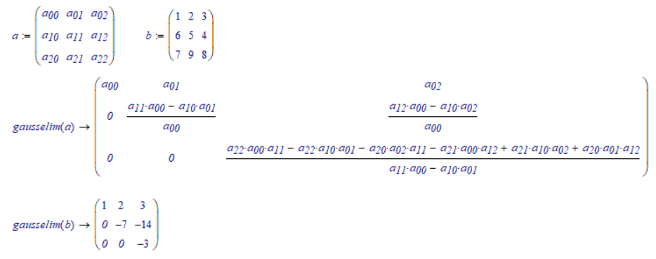

I try in Mathcad to build  Gauss-Jordan method for obtaining the inverse matrix but it looks quite difficult.
It is closed to Jordan elimination method, but on the right side we consider initially (in the augmented matrix) an unit matrix. Did anyone build this method in Mathcad?

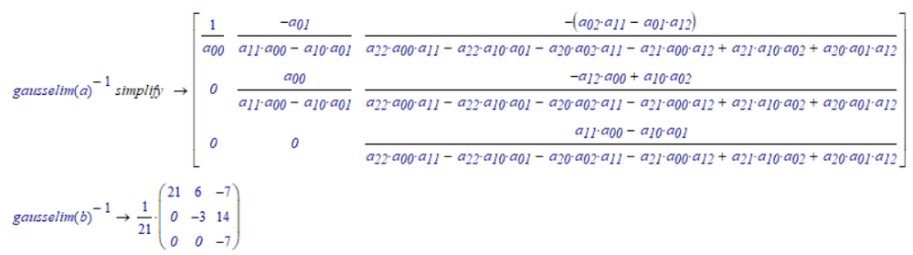

LucMeekes
(To:tubar)

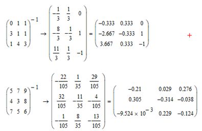

You want it more like this?
Or is it this (the inverse of each of the matrices):

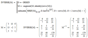

Close? The reason I pointed you at this thread was because Alvaro implemented there exactly what you had asked for! His RREF uses Gauß-Jordan and not only gives you the inverse of a square matrix but returns additionally the determinant and the rank. If you don't like the latter, just ignore it and pick the inverse only.
You may do this by using his RREF routine as it is
or modify his program slightly to just return the inverse matrix.

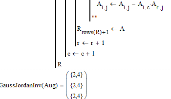

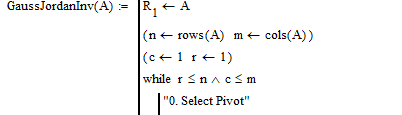

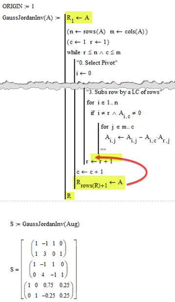

I give you an example how I want to be builtthe algorithm. Just like the simple Gauss elimination method attached at this message. It is taken from L. Fausett - Numerical Methods Using Mathcad   .   Now I am clear, I hope.
(To:tubar)
OK, but where is is the point you have troubles implementing the algorithm? What have you yourself tried so far? Maybe we can help you with your efforts.
And whats wrong with Alvaro's RREF?
Alvaros routine does exactly what you want.
Just augment the unity matrix at the begin of the program and at the end return only the last part of matrix A (using submatrix). All this very similar to what I had shown in the picture above in the extern routine "INVERSE".
You may delete all references to d and rho as they are not needed to calculate just the inverse with Gauß-Jordan.
Be aware that Alvaro's program is assuming ORIGIN=1.

It looks to me like you did not understand what Alvaro had written and not what I had done with his routine creating the INVERSE function.
You may want to have a further look at his sheet.
The symbolic evaluation was chosen to show you that you really get the correct result with the iteration compared to Mathcads built-in inverse
tubar

Yes, sure. His routine does more than you demand for. It returns the echelon form, the determinant and the rank!
And if you augment the unity matrix after the matrix and feed the routine with it, the echelon form would mean that the second half of the matrix is the inverse you are looking for!
Here are all the changes that have to be done to get a routine which returns the inverse.
But keep in mind that no error checking is done and so you get a (wrong) result in case the rank is smaller than the row number and the matrix is not invertible though. Furthermore Alvaro's sheet assumes ORIGIN=1. If you want to use his routine in a sheet with ORIGIN set to another value, you have to make changes here and there.

I studied more that file of Alvaro.  In fact RREF( ) is an operator of Mathcad.   I modified the file of Alvaro (I attached it here) and now I obtain the INVERSE through Gauss-Jordan Method.
It remains a problem: how I can vectorize the problem in order to get all the steps (intermediary forms) of the inversion process.
I dont ant just only the final form of the INVERSE, but also the forms for each step i=1...n.
(To:tubar)
Something like this?
In case you need more intermediate steps and you really mean the i-loop, you would have to move the highlighted line as indicated in the picture to get this result:
Upon further thinking about it I guess it would make more sense to move the line one up into the if-condition (replacing the "" now there). This should avoid duplicates. In case of your example there is no difference to the first variant, but with larger matrices you should get more steps that way. Think of that line (R[rows(R)+1 <-- A) as a way to make a photo of the condition of the matrix at the moment. Throw it in wherever you find appropriate. You may use this line multiple times, too, if needed.
tubar
(To:Werner_E)
Yes, something like that, but for me doesn't work. For me it shows something like{2,4}...etc.
LucMeekes
(To:tubar)
 Select the result (the one containing the {2,4}'s), and from the menu Format=>Result, then "Display options" tick "Expand nested arrays".
