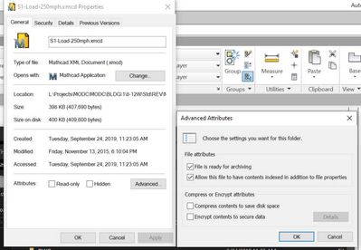

Maybe the attributes of the file ( in the Operating Systemm, not in Mathcad) were changed to Read-Only...?
What type ('real' or Prime) and version (number) of 'mathcad'?

So what, according to your client's file manager (such as Windows Explorer), are the attributes of the mathcad sheet file in question?
(With Windows Explorer: click the file, press the RIGHT-hand mouse button and select 'properties' from the pop-up. Read the attributes at the botoom of the properties window.)
If the attribute 'Read-only' is ticked, untick it and OK the form. Immediately thereafter check the properties again. If it's still/again 'Read-only', then it may be an access/rights issue. Independently of the attribute setting, it may  be an acces/rights  issue regarding the directory or the server.
Looks good to me.  I wonder what else it could be?
