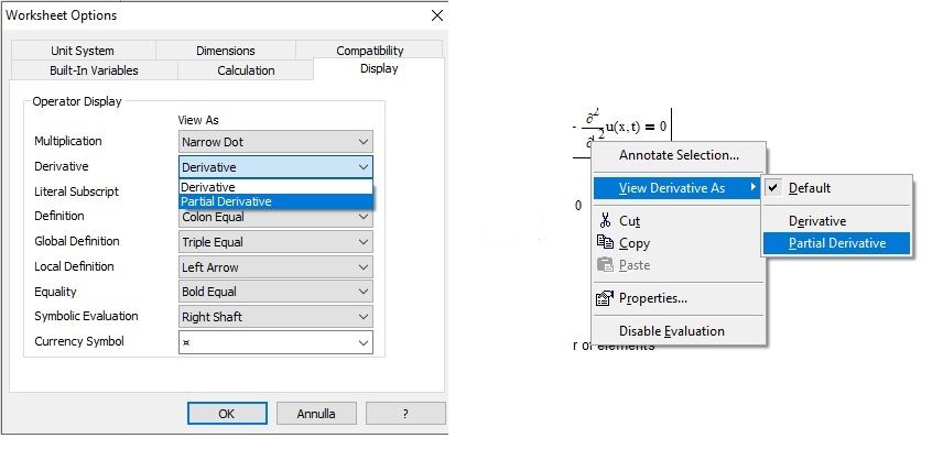

Please note that Mathcad offers the "Pdesolve" operator for partial differential equations with some examples. Obviously it is not suitable for educational purposes. To be clearer you should write in the worksheet the difference scheme indicated in the text. Finally, I let you know, for your correctness in writing the differential equations, that there are the following two options to write the simple and the partial derivatives:
