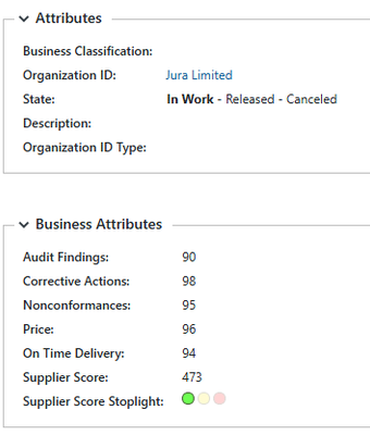

There are a few simple options via the GUI that you could use to represent your warehouse/distribution centers:
  • Add a new attribute set to the Part object that includes the warehouse name and other attributes, then modify the Part layout to group the set.
  • If you use the Supplier Management module, you can create a subtype of Supplier (e.g., Warehouse). The parent type uses a life cycle template. The image included here has its own attribute set to track supplier-related details (similar to the first bullet item).
