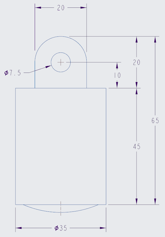

I've gone through the drawings and found that I'm missing the following pieces of information from the drawings.

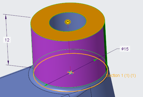

  1. Drone Body
    1. The radius on the outside legs of the drone
      • I found it as 12.5 in the sketching tutorial - but it's not on the drawing.
    2. The diameter of the top cylinders
  2. Camera
    1. I'm having a conflict between the 65 "OAL" dimension and the 15 length on the tab. With the 45 + 15 + 10 the OAL should be 70.

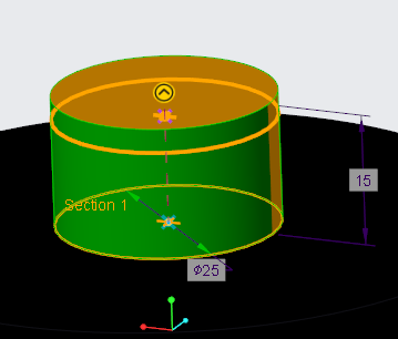

  3. Camera Mount
    1. I don't have the length of the Ø25 cylindrical portion
  4. Rotor Blade
    1. The depth of the Ø7.5 counter bore is missing.
BenLoosli
(To:KateLeipold)
Camera can be designed with those values, it just looks a bit different. It puts the 7.5 hole closer to the full radius instead of both being on the 15 dimension.
The 'screws' have no thread pitch callout and the hex should be dimensioned across the flats, not across the hex.
KateLeipold
(To:BenLoosli)
I agree with both of these comments
Thanks for the feedback here. I will work with the author who created this content to re-check the drawings, but you're correct - it seems there are various dimensions missing and there are some inaccurate dimensions.
  1. Drone Body
      The diameter is 15:
  2. Camera
      My assumption is that this drawing was created as the data set was being developed, so there are some inaccuracies to the final dimensions. Here is what the correct dimensions should be:
  3. Camera Mount
      That value should be 15.

If you're making changes to the camera - make sure they match this step - https://learningconnector.ptc.com/playlist/PL1638967972260/get-started-with-creo-parametric-assembly/tutorial/1648035744386/measure-global-interference
Changing the 20 - 25 doesn't do anything if the hole is measured 10 rather than coincident.
