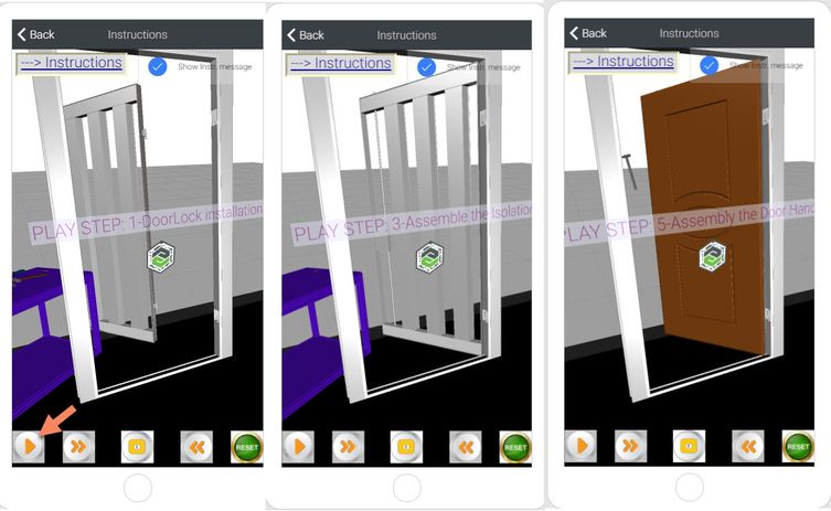

This example briefly describes how you can use the Step names that you used in Creo Illustrate sequence definitions to drive a corresponding step instruction/description in your experience. This is an unsupported, preliminary solution - R&D is working on a better, final solution. But as long as this is not available, you can use this one for PoC and demo purposes.
To setup the scene: Here is what I meant with Step names that you used in Creo Illustrate:
Now in Thingworx Studio you want to have the following result:
The text is rendered with a simple Label widget. You'll have to remember the ID of this widget for the following javascript tweak. Add the following text to the Javascript section of your View:
var labelId = "label-1"; // ID of the Label widget that displays the Step progress and description  text
// this $on event handler switches the label based on the the sequence definition
// the arg variable is of the following form: (<step #>/<total step #) <step name>
$scope.$on('newStep', function(evt, arg) {
  $scope.setWidgetProp( labelId, "text", arg); // get the currentStep from the arg
Now you only need to provide the correct initial value in the Label widget text property and add control widgets (Buttons, Playback) to drive your animation and you're done.

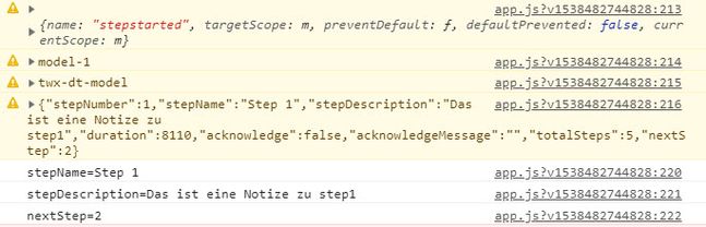

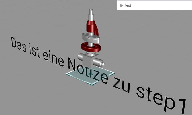

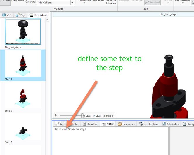

As per the previous two comments, I'd also like to know if there is a way to extract out the step description.  If I follow your example, the label shows (<step #>/<total step #) <step name>:
As Thomas showed in his previous post, in Creo Illustrate, you would type in detailed information in the notes tab which in the PVI file is stored as step_decription.
If found that in the sequence.js file in the project folder, the function SequenceStep(step) gets the following properties:
  • step_name
  • step_duration
  • step_acknowledge
  • step_description
And in the vuforia-angluar.js file, there's the definition of the newStepEventArgument that is set to (current step / total steps) step name.
So the question is, how to we extract out the information like step_description into the label text?
Many thanks,
Allan

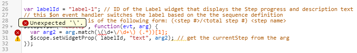

July 25, 2018
You can cut of the first part e.g. '( 1/11)  ' with a regexp  so that you end up with just the title.
The code snippet would look like this:
 var arg2 = arg.match(\(\d+\/\d+\) (.*))[1];
 $scope.setWidgetProp( labelId, "text", arg2); // get the currentStep from the arg
July 30, 2018
Hmm... It gives me an error.
