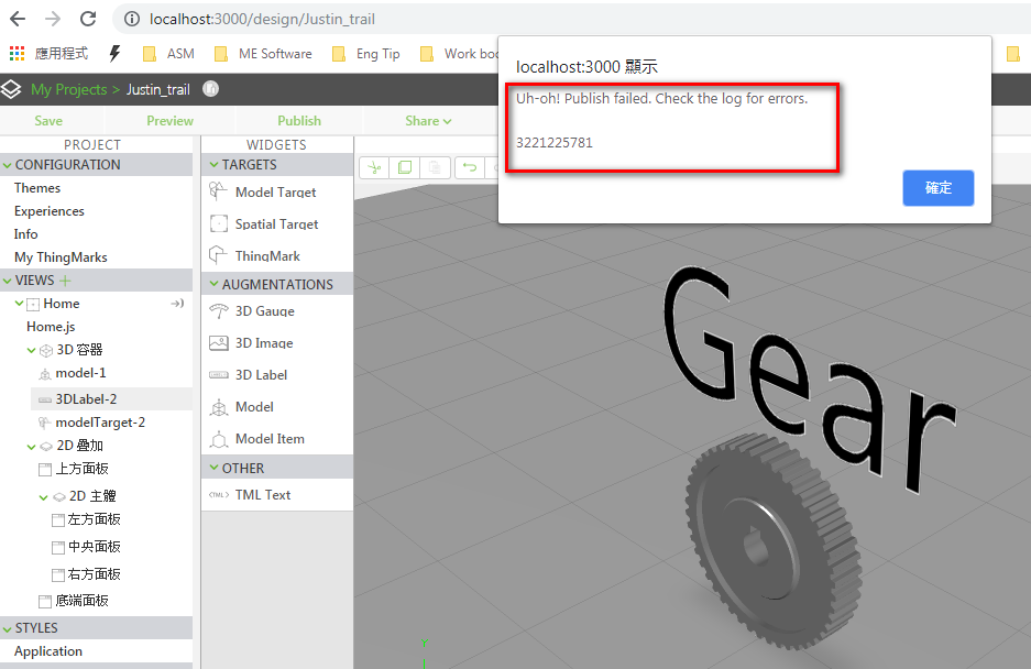

I created an experience with model target tracking, but can not publish to cloud server.

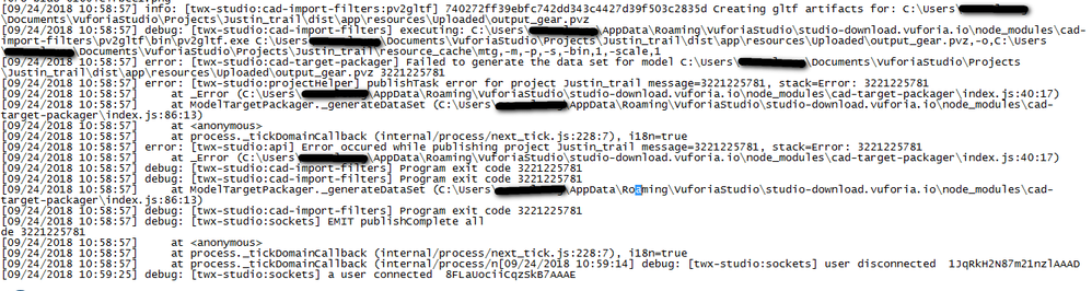

Here are errors from the log:
1 REPLY 1

@Justin_Leung Could you please confirm if you are using Studio Trial instance or commercial Experience service ?  If possible please share your ES URL.
-Durgesh
