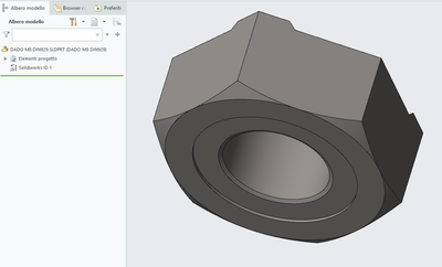

I'm trying to import some component from Solidworks Toolbox. When the component has a configuration name different from "Default", the asm.mbr.name attribute and the name in the tree of the component is "NAME(CONFIGURATION)". I can never manage this name and also appear in the attribute of the BOM table

Attached some samples of the wrong behaviour.
As you can see in the picture I can't change the parameter asm.mbr.name

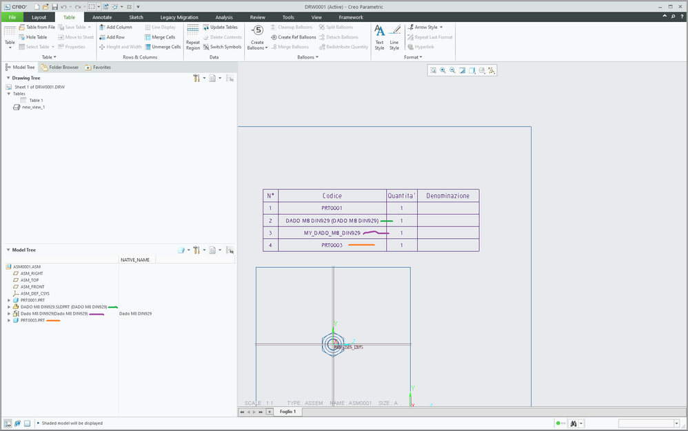

Ok, it is clear.
@Fortech wrote:
Ok, it is clear.
green item (your solution)
  • File > Open
  • component cannot be renamed
violet item
  • File > Import (Open button switched to Import)
  • component can be renamed
  • component name is not visible in model tree
  • component name is displayed in repeat region
orange item
  • File > New ... new empty part
  • Get Data > Import ... SLDPRT imported
  • component name is visible in model tree
Suggestion: Use violet or orange "solution".

Ok, it means that i need to manage every single compontent of my previous toolbox.
I was looking for a solution that can speed up the transfert between the two CADs.
In any case I need to open each component.
Thanks a lot
