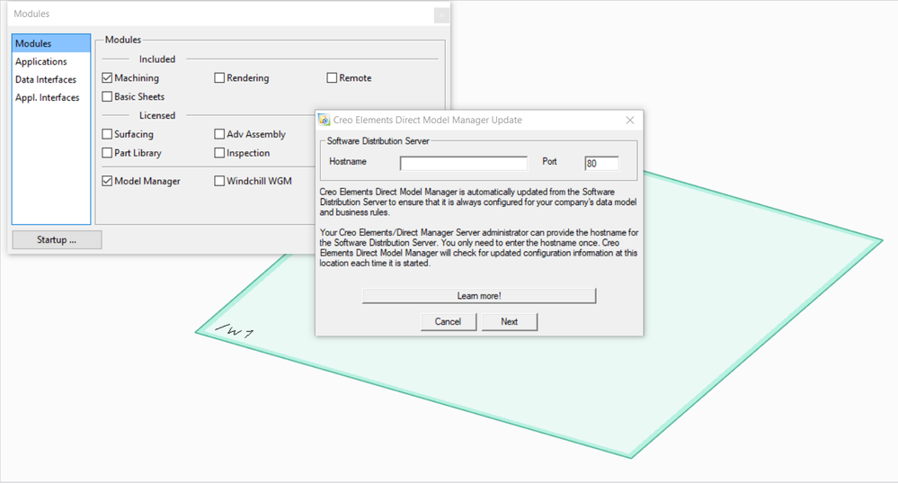

License PTC Creo Elements/ Model Manager
Dear Sir/ Madam.
This is  license PTC Creo Elements/Model Manager. i dont know why cant fill right hostname.
Plz, help me support this problem.
Thank you very much!

Let have a look to the file Direct Model and Drawing Manager 18.1\getnrun.ini and check if the url (ex: url=http://MyModelManagerServer:80/ModelManagerSetup.exe) makes reference to your Model Manager Server environment.
If not (probably) let make adjustment, or remove and reinstall your Model Manager client.
thank you so much!
