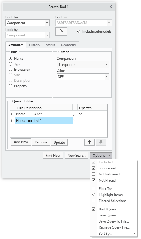

In Creo Parametric, is there a way to search/filter the model tree for a list of part numbers at once instead of searching for part numbers one at a time?

Yes, you can use the find tool (CTRL-F). Make sure to select Build Query from the options and then you can use the AND and OR operators to narrow down what it is you are looking for.
