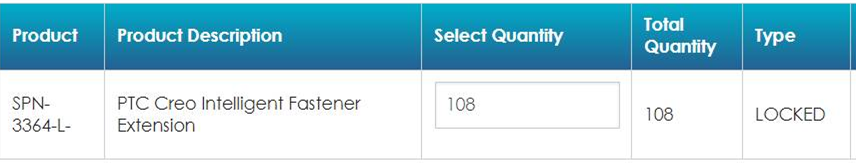

When I select more than one locked license to install on my server it will only transfer one locked license to the server. This image shows that I've selected 108 to transfer.

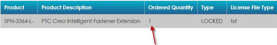

The confirmation window shows it's only going to transfer 1 license. I've done this three times, so now I have three of these in my license. I only have to do this 107 more times to get them all in the license.

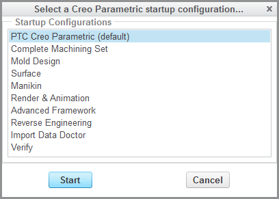

I have the same ten different license configurations defined on every install of Creo. When the users starts Creo, they see this menu that lets them pick between the differnent license configurations. Components like the Complete Machining Set, I restrict to a specific group of users using the ptc.opt file. There is nothing special you have to do to get this menu other than create multiple license configurations, and in your startup script call parametric.exe, not one of the .bat files created when you create the additional license configurations.
