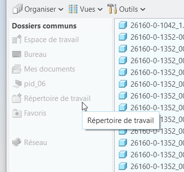

For option no.1, what I don't know how to do is disconnect Windchill server.
I can't find.
Even starting directly parametric.exe, server is displayed.
And if I'm trying to open an old part (created without any pdm), I can't "save as".
All options are greyed and I just can save in pdm cache.

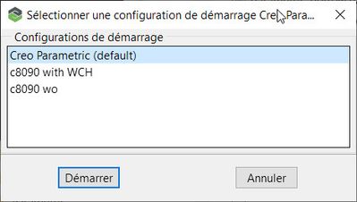

For option no.2.
It works fine !
Thanks a lot !
However, I've probably misunderstood something.
Directory : C:\PTC, C:\PTC\PTC_FT_ROOT_withWCH is created and is empty.
Directory : C:\PTC, C:\PTC\PTC_FT_ROOT_withoutWCH is created and is empty.
parametric_withWCH.psf has been created as you said.
parametric_with.psf has been created as you said.

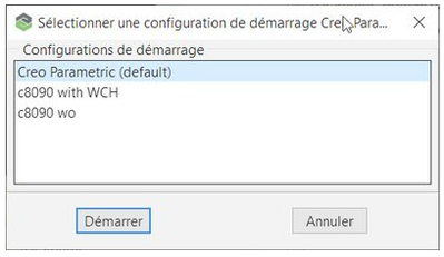

So, When I'm starting Creo, I have 3 options.
The first one connects to Windchill as I need for my customer.
2nd and 3rd allowed me to work outside Windchill. Fine.
But both options are exactly same, as both directories are empty.
What is the aim of those both options ?

How do you start Creo. Do you use shortcut using parametric.exe ? If the answer is YES then C:\PTC\PTC_FT_ROOTxxx directories cannot be empty.
If you upload parametric.psf file, I will be able to tell you whether it contains some special settings.

So, For my customer, I have a shortcut to his server (a lot of SET... and it works with his PDM.
For my own jobs, I'm just starting a cmd file :
"C:\ptc\Creo 8.0.9.0\Parametric\bin\parametric.bat"

Windchill customer cmd
If you cannot publish this file then I am not able to give you any advice.
parametric.bat
By default it contains following lines (below is contents from my Creo 10.0 installation).
@echo off
"E:\PTC\Creo10_000\Creo 10.0.0.0\Parametric\bin\parametric.exe" "E:\PTC\Creo10_000\Creo 10.0.0.0\Parametric\bin\parametric.psf" %*
This means that in uses information saved in parametric.psf
INFO: For example, you can replace parametric.psfwith parametric_withoutWCH.psf.
Note:
I do not know how did you get following window ... I guess customer cmd calls parametric.exe
