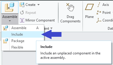

I am using Creo Parametric Release 7.0 and Datecode7.0.5.0
I received a file (.asm) that contains an sub-assembly with a icon that I do not know. Similar icon to assembly type, but gray color...
What is it? how is it created and how is it modified?

A screenshot would be helpful for identification.
Are you referring to the windows icon or the model tree icon?

model tree icon, see below image. thanks

Unplaced assembly. You probbably need to define assembly constraints.
Hi @GA_3588145
Shown icon is of unplaced assembly  ICON in Help
Details can be seen at :
About Unplaced Components (ptc.com)
I hope this will help.
